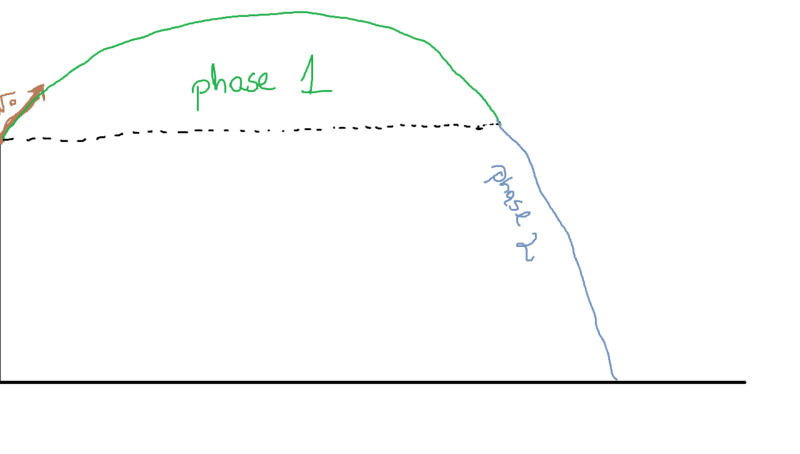

A sniper standing on a 70 meter-tall tower fires his rifle at 30 degrees upwards with the initial velocity of 1000 m/s. What is the range of the bullet and how much time will pass before it hits the ground? Assume no air-resistance.
2. The attempt at a solution
I divided the motion of the bullet into two phases, the first one - until the bullets reaches the level at which it was released and the second one - from the end of phase 1, until it hits the ground. Therefore, in order to find the total distance the object will cover, I need to find the time each of these phases will take:

In order to find the time the second phase will take, I calculate how much time it will take the object to fall from y = H to y = 0:

Could you tell me if I've tackled this problem correctly?
Yep, looks correct.
But can you think of a sign convention that can makes these 2 phases into 1?
