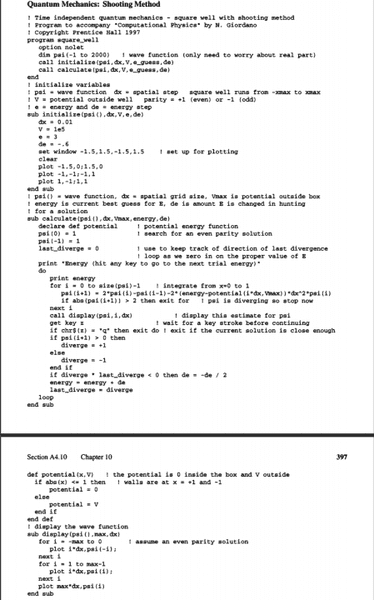

Hello! I am trying to write a program that solves the Schrodinger Equation for a particle in an infinite square well. I did a lot of research regarding the methods that could be used to accomplish this. I am writing this program in Matlab. The method I am using is called the Shooting Method. In my code below, when I plot psi vs. x_negative, I do not get a wave function that looks like what we expect. I am not sure where I am going wrong with this. I also don't know how much details I should include in this thread. Please, ask me for more information if needed. I have also attached picture of the textbook I am using for my logic. It is from the Computational Physics textbook by N. Giordano. Thank you very much for your help!
So what do you get?
One thing that bothers me is
Matlab:
psi(1) = 1;
psi(2) = 1;
This is not a valid slope for the wave function. You need to initialize the 2-point recursion with psi(1)≠psi(2).
