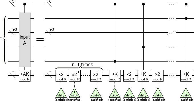

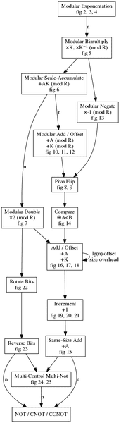

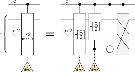

Ok I get it. But i still have some hard times to understand the phase-estimation. I think the bottom question is : How do I implement the controlled-U to implement ax mod N?
You break it down into simpler and simpler operations until you're left with just (a whole lot of) constant-sized operations.
I've been working on a paper that does this. Here's my simplified dependency graph:
And two of the steps, as an example:
