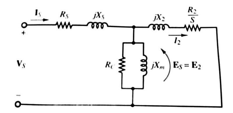

GoodPost said:
It's assumed that the core losses are neglected and hence Rc =0.
No, it means Rc is infinite. Not short circuit, but open circuit.
When an impedance (R or X or C) is short circuited, it can be neglected in the circuit.

It makes sense the way you interpreted it, but it's still confusing me since Rc=0 is actually assumed in the problem statement and if the resistance = 0 that means it's a short circuit, right? Plz check the attached photo.

In your schematic, if Rc=0, then it short circuits everything except Rs and Xs. Does that make sense to you?
I believe it's a typo.
Have you performed 'no load' and 'blocked rotor' tests on an induction motor in your lab? The R2/s in the circuit is actually the sum of two components: 1) rotor resistance R2 (slip independent) and 2) the electrical equivalent of the mechanical load i.e. Rm=R2*(1-s)/s .
While analysing the blocked rotor circuit, we substitute s=1 in the above circuit. This gives Rm=0, and this corresponds to maximum copper loss. While analysing no load circuit, we put s=0 and get Rm=∞, which corresponds to zero (almost) copper loss.
