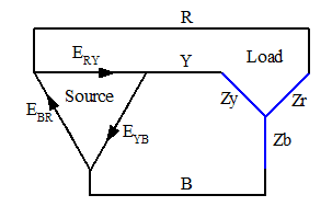

Okay, so with one of the loads shorted you're left with two loads with 415 V across each. They are effectively independent with separate voltage sources driving them, but share one of the phase wires. Let's see how we can draw the resulting circuit in a way that's convenient for analysis.
Consider a general setup where a Y load is being driven by a Δ source:
The Δ source voltages ##E_{RY}##, ##E_{YB}##, and ##E_{BR}## supply the line-to-line 415 V potential differences. Zr, Zy, and Zb are the individual load impedances. You should be able to assign the phase angles to each of the source supplies; just start at 0° and subtract 120° for each as you go around the Δ of sources (to preserve the sequence R-Y-B for the phase voltages). What's important is that the appropriate relative phases are preserved.

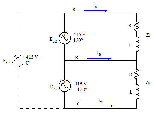

If load Zb becomes shorted then that will put source ##E_{YB}## directly across load Zy, and source ##E_{BR}## directly across Zr. Assuming that the sources are ideal, nothing is going to influence their voltages and phase angles. So those loads are going to be driven by those supplies and we can ignore the ##E_{RY}## source. We're looking for the line currents for the lines R, Y, and B.
Rearrange the diagram to place the B line in the middle (since it's become a convenient "common" node for the two remaining loads thanks to Zb being shorted). Keep track of the source phases and directions! Note also that -240° is the same as +120°. We have:
That should be easy enough to solve for the currents.

Okay so I worked them both ways and I'm encountering a problem.
Using the formula I derived for Ib from the phasor diagram I substituted Iy & Ir = 1.8346A which I obtained from Ir(or Iy) = 415/|Z|
where Z = R+jXl i.e Z = sqrt(R^2+(omega*f)^2)
I previously calculated R as 47.17ohms and L as 0.59H
This resulted in me getting Ib as 1.8346A as well.
However using your method I attempted it using Mesh analysis
For Mesh 1:
415<120= -I1*Zr
I1 = 1.8346<-60 where I1 = Ir
For Mesh 2
415<-120 =-I2*Zy
I2 = 1.8346<60 where Iy = -I2 i.e Iy = 1.8346<-120
Ib = I2-I1
= 1.8346<60-1.8346<-60 = 3.177<90
