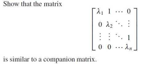

need to show companion matrix is similar to the following matrix
(here is the picture of the matrix)
here is the companion matrix
http://en.wikipedia.org/wiki/Companion_matrix
information on matrix similarity
http://en.wikipedia.org/wiki/Matrix_similarity
say given matrix is A and companion matrix is C then need to show
A = P^-1 * C * P for some invertible matrix P
i guess i could reduce guesswork by rewriting as
P*A = C*P
but even then it does not seem to be the ideal way to go about things.
I don't think you put in the right link to the matrix...
oh lol fixed
What is the characteristic and minimal polynomial of that matrix? Can you construct the rational canonical form based off of elementary divisors?
i know char for companion but that is all.
i also know:
if same minimal poly then similar
if same frobenius canonical form then similar
but no clue how to go about finding them
Since your matrix is upper triangular, finding the characteristic polynomial is easy: It is just ##∏ (x-\lambda_i)##. If you can show that this is the minimal polynomial as well, then you are done.
