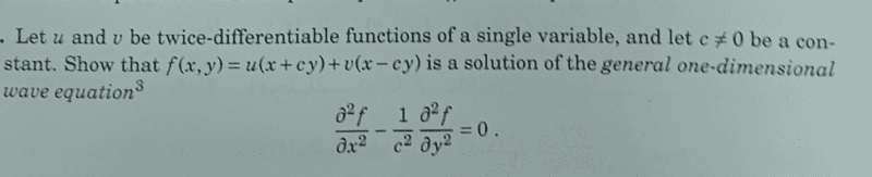

Show that ##f(x,y)=u(x+cy)+v(x-cy)## is a solution of the given PDE

See attached.
wave equation.
Looks pretty straightforward, i approached it as follows,
##f_x = u(x+cy) + v(x-cy)##
##f_{xx}=u(x+cy) + v(x-cy)##
##f_y= cu(x+cy) -cv(x-cy)##
##f_{yy}=c^2u(x+cy)+c^2v(x-cy)##
Therefore,
##f_{xx} -\dfrac{1}{c^2} f_{yy} = u(x+cy) + v(x-cy) - \dfrac{1}{c^2}⋅ c^2 \left[u(x+cy)+v(x-cy) \right]##
##f_{xx} -\dfrac{1}{c^2} f_{yy} = u(x+cy) + v(x-cy) - u(x+cy) - v(x-cy) =0##
thus shown.
Unless there is a different way to look at it...cheers.
Amendment in post ##5##.
Looks ok, but as always you can of course also look at it in a different way. 😉
Consider the wave front coordinates:
\xi = x - vt,\qquad \eta = x + vt
and use the chain rule to rewrite the wave equation in terms of those coordinates. The resulting PDE is very straightforward to integrate.
Likes chwala
Shouldn't the derivatives of ##u## and ##v## appear somewhere in that equation?
Likes chwala and Steve4Physics
chwala said:
Homework Statement: See attached.
Relevant Equations: wave equation.
Are you sure the above is correct? It seems you are saying that ##f = f_x## (as both would be equal to ##u(x+cy) + v(x-cy)##.
Note that ##u## and ##v## can be any twice differntiable functions of a single variable. For example ##u(z) = z^2## and ##v(z)=z^3##. These would give ##f(x,y) = (x+cy)^2 + (x-cy)^3##.
It should be clear that ##f_x## and ##f## would then be different functions of ##x## and ##y##.
Likes chwala
I see...i ought to make use of chain rule differentiation ...let me amend and repost. A minute.
...should be,
##f_x = u^{'}(x+cy) + v^{'}(x-cy)##
##f_{xx}=u^{''}(x+cy) + v^{''}(x-cy)##
##f_y= cu^{'}(x+cy) -cv^{'}(x-cy)##
##f_{yy}=c^2u^{''}(x+cy)+c^2v^{''}(x-cy)##
Therefore,
##f_{xx} -\dfrac{1}{c^2} f_{yy} = u^{''}(x+cy) + v^{''}(x-cy) - \dfrac{1}{c^2}⋅ c^2 \left[u^{''}(x+cy)+v^{''}(x-cy) \right]##
##f_{xx} -\dfrac{1}{c^2} f_{yy} = u^{''}(x+cy) + v^{''}(x-cy) - u^{''}(x+cy) - v^{''}(x-cy) =0##

Steve4Physics said:
Be careful because your notation is ambiguous.
For example, does ##u^{’}## mean ##\frac {\partial u}{\partial x}## or ##\frac {\partial u}{\partial y}##? You have used ##u^{’}## to mean both! Similarly for ##u^{''}##.
Neither, it means ##u'##. The function ##u## is a function of one parameter only and the derivative is with respect to that parameter. There is nothing ambiguous about this notation. That you then put a composite function as the argument is another issue.
Aagh. Yes, I was being daft.
