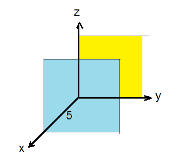

You are given the potential finction V(x,y,z). It is not the potential of a point charge. You need the curve in a plane parallel to the (y,z) plane. What do you know about x in that plane?
I'm not entirely sure to be honest.

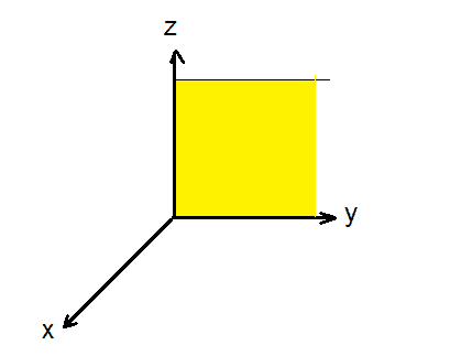

What is x on the (y,z) plane?
zero? Sorry, not entirely following here.
yes.
And what is x on the blue plane, parallel with the (y,z) plane?
ehild said:
yes.
Five, I guess?
Erik P said:
Five, I guess?
yes. Read the problem, you are given that x=a=1.0 m and V=1000 volts. How the potential function looks like if x= 1.0 m?
