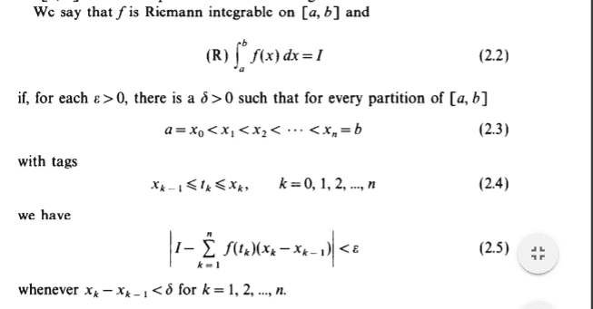

So from the $(\star)$ we will have that $\forall \epsilon>0$ there is a $\delta>0$ such that $|u(t,x)-\phi(x)| \leq \epsilon$ if $0<t< \delta$, i.e. $\lim_{t \to 0} u(t,x)=\phi(x)$.First of all, I have found that the definition of the generalized Riemann integral is the following:
In our case, at the integral where we use this definition , we have an open set, namely this one $\mathbb{R}^n \setminus{Q_R}$. Do we pick an arbitrary $[a,b] \in \mathbb{R}^n \setminus{Q_R}$ and consider a partition of it?
If so, then we have that for each $\epsilon>0$ there is a $R>0$ such that for every partition of $[a,b]$
$a=x_0 < x_1< x_2< \dots<x_n=b$
with tags $x_{k-1} \leq t_k \leq x_k, k=0,1, \dots,n$ we have $$\left| \int_{\mathbb{R}^n \setminus{Q_R}} e^{-|\sigma|^2} [\phi(x+2 \sqrt{t} \sigma)-\phi(x)] d{\sigma}- \sum_{k=1}^n e^{-|\sigma|^2} [\phi(x+2 \sqrt{t} t_k)-\phi(x)] (x_k-x_{k-1}) \right|< \epsilon$$
whenever $x_k-x_{k-1}<R$.Do we pick now $x_k-x_{k-1} \to 0$ in order to get the inequality for the integral?

Hi evinda! (Smile)
I believe you've quoted the definition of a non-generalized Riemann integral.
However, it only applies to functions with a domain that is an interval in $\mathbb R$.
Shouldn't we look at a multiple integral, since we have a function with a domain in $\mathbb R^n$? (Wondering)
Or actually the Lesbesgue integral that applies to functions on any domain? (Wondering)
Note that your integral is of the form $\int f\,d\mu$.

Ok... where can we find the $\epsilon, \delta$-proof of these integrals?
