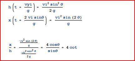

A projectile launched at angle Θ to the horizontal reaches maximum height h. Show that its horizontal range is 4h/ tan Θ.
tapex = [itex]vi sin Θ/g[/itex]
tfull trajectory = [itex]2vi sin Θ/g[/itex]
h(tapex) = h = [itex]vi^2 sin^2 Θ/2g[/itex]
x(tfull trajectory) = x = [itex]\frac{vi^2 sin (2Θ)}{g}[/itex]
Consider the ratio of range to max height.
I did. The expression for the full range and heigh, h is in the op.
But I'm unable to reduce them to the appropriate wxpression
Show what you get and how you get that.
I worked out hapex = vi ^2 sin^Θ and xfull range = vi^2(2Θ)/g
The above was obtained by substituting t/2 intp the y-displacement and t into the x-displacement.
As I said. Consider the ratio of range to max height.
I did.
The horizontal range is 2vi^2 sinΘcosΘ.
I simplified 4h/tanΘ to 2vi^2sinΘcosΘ/g.
I suppose this is a sufficient condition for the proof?
I cannot see your analysis of the ratio of range to max height. Which is strange, because you have found a formula for range, and a formula for max height. All you need is to divide one by another.
I failed to obtain the required equation. Why do we need the ratio? The question has not asked for that.
My method:
I found x = vi^2 sin(2Θ)/g = 2vi^2 sinΘcosΘ
I reduced 4h/tanΘ to = 2vi^2 sinΘcosΘ, where h = vi^2 sin^2Θ/2g and tan Θ = sinΘ/cosΘ.
You are required to prove that $$ x = {4h \over \tan \theta} $$ That means $$ {x \over h} = {4 \over \tan \theta} $$
Regarding your "failure", how are ## \cot ## and ## \tan ## related?
cot Θ= 1/tanΘ
It never occurred to me I had to perform a x/h ratio. But anyway, answer found.
