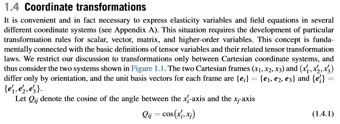

My apologies! The book defines ##Q_{ij}## as the cosine of the angle between the ##x^{'}_{i}## and ##x_j## axes. See attachment.

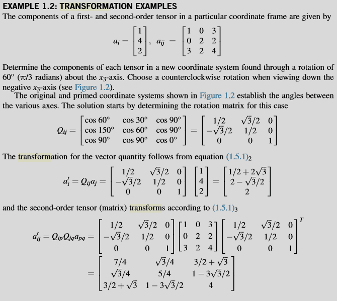

Ok, so I'd like to zoom out here and get a better understanding of ##Q_{ij}##. I'm trying to do a basic example problem where the solution is given in the book (see attached image).
I can calculate the transformation matrix, ##Q_{ij}## (did it without looking at the solution, woot!), and do the transformation of the vector, ##a_{i}##, no problem. However I am stumped by the transformation of the 2nd order tensor, ##a_{ij}##. The solution given points you to the equation ##a^{'}_{ij} = Q_{ip}Q_{jq}a_{pq}##. I don't understand how this turns into ##Q_{ij}a_{ij}Q^{T}_{ij}##.
I guess one of the things I am fundamentally not understanding is what is the difference between ##Q_{ip}## and ##Q_{jq}## in the equation you are supposed to use? And how are they different than ##Q_{ij}##?

It doesn't. It turns into
$$a^{'}_{ij} ~=~ Q_{ip} a_{pq} Q_{jq} ~=~ Q_{ip} a_{pq} Q^T_{qj} ~=~ \Big(Q a Q^T)_{ij} ~.$$
The ##i,j,## are ordinary indices -- they must match up on both sides of the equality. The ##p,q## indices are dummy summation indices (implicit sum over repeated indices). I.e., there's an implicit ##\sum_p \sum_q##. See Einstein summation convention. (That reference is for a more general case where there are both upstairs and downstairs indices, whereas in your case all indices are downstairs. Same principle though.)
Trying sticking those explicit "##\sum##" symbols back into the equation, and then relate it to how one multiplies matrices.
Btw, I sense that you really need to study some books on linear algebra and vector/tensor calculus. The Schaum Outline series are usually good for covering a lot of material quickly, with example and exercises. Otherwise, ask for suggestions in the Academic Guidance forum.

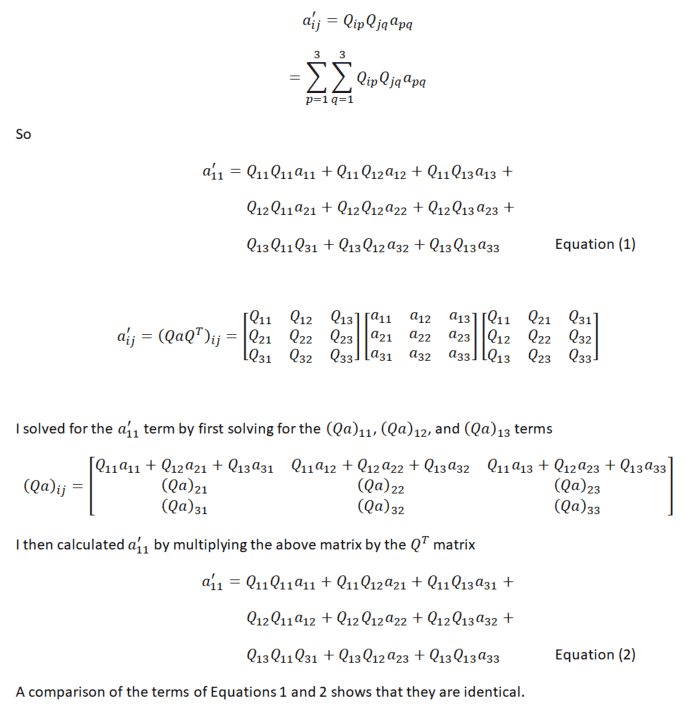

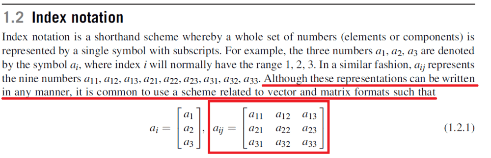

Thanks for the reply. That was my understanding before I got the textbook for this class and started reading through it. However, this textbook seems to use a notation where ##a_{ij}## represents a matrix. See the image below.
Also, in order to calculate the solution, we get to ##Q_{ip}a_{pq}Q^{T}_{qj}##. We are transposing the third symbol in the term, ##Q_{qj}##. It only makes sense to transpose ##Q_{qj}## if it is a matrix, and not a number, right?
I have no doubt that you are right and I am wrong. Just trying to highlight the things I don't understand, and I'm hoping to see the light.

You have good questions. The problem is the sloppiness of notation that is unfortunately widespread, which makes things confusing indeed.
1) When we write ##Q_{qj}^T##, we mean ##(Q^T)_{qj}##. The parentheses are important, but people usually drop them. So we mean the qj entry of the matrix ##Q^T##.
2) As for the notation used by the book, you are right that it is confusing. I am a physicist often working with mathematicians and I have been scolded by them more than once for writing things this way. Now I realize they they are entirely right, one should never write something like that! When people write a_{ij} = a matrix, they are badly abusing notation. What they mean is that if we let the indices range over all their values, we span the entire matrix. But it is incorrect to write that a_{ij} is equal to a matrix. Unfortunately, this is an abuse often done by physicists.
To be precise, a_{ij} is always an entry in the matrix, when we work with equations and manipulate terms.

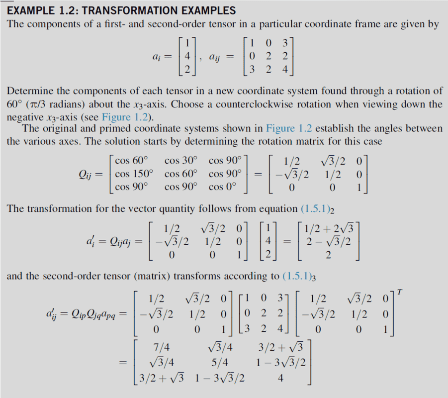

Thank you. That is a really helpful answer. So when I am looking at equations which are written in index notation, I should treat the elements of the equation as numbers, not matrices.
For me, that begs a new question. In order to arrive at the final solution (see first attached image), matrices are used. I don't understand the logic that determines what order the matrices are multiplied in or why the one matrix is transposed.
I think I understand the basic concepts of Einstein notation (is explained in the book, and strangerep explained it above as well). In order to convince myself that I understand Einstein notation, I calculated the first term of the transformed matrix, ##a^{'}_{11}## using summation, and then also calculated it using ##(QaQ^{T})_{ij}## and found them to be the same (see second attached image).
So I understand that ##(QaQ^{T})_{ij}## gets you the final answer. I just don't understand the thought process for getting to ##(QaQ^{T})_{ij}##.
My guess is that I simply need to shore up my fundamentals, which I am planning on doing. If there is no clear answer to my question, no worries. I will give up on this problem for now and come back when I have the background to understand. Thanks everyone for the help.

OK. Consider the column vector in your example, whose components are denoted ##a_i##. Do you understand why $$a'_i ~=~ Q_{ij} a_j ~~~?$$ And what is this in matrix language? (Once you're clear on this, we'll move on to 2nd rank tensors.)
