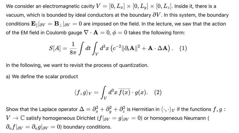

Hi,
the task is as follows:
I now have to show the following
$$\begin{align*}
\langle f , \Delta g \rangle &= \langle \Delta f , g \rangle\\
\int_{V} dx^3 \overline{f(x)} \cdot \Delta g&= \int_{V} dx^3 \overline{\Delta} \overline{f(x)} \cdot g\\
\int_{V} dx^3 \overline{f(x)} \cdot \Delta g&= \int_{V} dx^3 \Delta \overline{f(x)} \cdot g\\
\end{align*}$$
Unfortunately, I can't get any further because I don't know how to show that the equations are equal. I assume that Dirichlet and the Neumann boundary conditions must be used, unfortunately I don't know how to include them in my expression above.

Integration by parts can be used to transfer a derivative acting on ##g## in the integrand to a derivative acting on ##\overline f##.

I started with the integral on the left-hand side:
$$ \int_{V} dx^3 \overline{f(x)} \cdot \Delta g=\int_{\partial V} dS \overline{f(x)} \cdot \partial_n g-\int_{V} dx^3 \Delta \overline{f(x)} \cdot \Delta g =-\int_{V} dx^3 \Delta \overline{f(x)} \cdot \Delta g$$
And the following applies to the right-hand side
$$\int_{V} dx^3 \Delta \overline{f(x)} \cdot g=\int_{\partial V} dS \partial_n \overline{f(x)} \cdot \Delta g-\int_{V} dx^3 \Delta \overline{f(x)} \cdot \Delta g =-\int_{V} dx^3 \Delta \overline{f(x)} \cdot \Delta g$$
Then the following applies to both sides, which I should show:
$$-\int_{V} dx^3 \Delta \overline{f(x)} \cdot \Delta g=-\int_{V} dx^3 \Delta \overline{f(x)} \cdot \Delta g$$

The integrand of the last integral is not correct. In this integral did you mean to use the notation ##\vec \nabla## instead of ##\Delta##?
Note that $$\int_{V} d^3x \overline{f(x)} \cdot \Delta g = \int_0^{L_z} \int_0^{L_y} \int_0^{L_x} \bar f \left( \partial_x^2 + \partial_y^2 + \partial_z^2 \right) g \, dx dy dz $$
Consider the x-integral of the first term in the integrand: ##\int_0^{L_x} \bar f \, \partial_x^2 \, g \, dx##. What do you get if you integrate this by parts twice?
Another approach is to make use of the divergence theorem (Gauss' theorem) and the identity ##\vec{\nabla} \cdot (\phi \vec A) = (\vec \nabla \phi)\cdot \vec A + \phi \vec \nabla \cdot \vec A## where ##\phi## is a scalar function and ##\vec A## is a vector function. I'll let you think about this approach. Maybe this is what you were trying to do in your approach.
Thank you TSny for your help 👍
You're right, I meant ##\vec \nabla## and not ##\Delta## :smile:
I have now applied partial integration twice for the dx integral and obtained the following
$$\begin{align*}
\int_0^{L_x} \bar f \, \partial_x^2 \, g \, dx&= \Big[\, \bar f \, \partial_x \, g\Big]_0^{L_x} -\int_0^{L_x} \partial_x \, \bar f \, \partial_x \, g \, dx\\
\int_0^{L_x} \bar f \, \partial_x^2 \, g \, dx&= \Big[\, \bar f \, \partial_x \, g\Big]_0^{L_x} -\Big[\, \partial_x \, \bar f \, g\Big]_0^{L_x}+\int_0^{L_x} \partial_x^2\, \bar f \, g \, dx\\
\int_0^{L_x} \bar f \, \partial_x^2 \, g \, dx&=\int_0^{L_x} \partial_x^2\, \bar f \, g \, dx
\end{align*}$$
The calculation for ##dy## and ##dz## would then be similar and if you then put them together, you have shown that ##\Delta## is hermitian

Looks good. Of course, it's important to see clearly that the boundary terms such as ## \Big[\, \bar f \, \partial_x \, g\Big]_0^{L_x} ## vanish if you have homogeneous Dirichlet conditions or if you have homogeneous Neumann conditions.
I would apply \nabla \cdot (f\nabla g) = f \nabla^2 g + \nabla f \cdot \nabla g to show that \begin{split}<br /> \langle \nabla^2 f, g \rangle - \langle f, \nabla^2 g \rangle &amp;= <br /> \int_V \nabla \cdot (\bar{g} \nabla f - f \nabla \bar{g})\,dV\end{split} and then use the divergence theorem. In fact the conclusion holds for the more general boundary condition <br /> \alpha f + \beta \frac{\partial f}{\partial n} = 0, \quad \alpha^2 + \beta^2 = 1.
