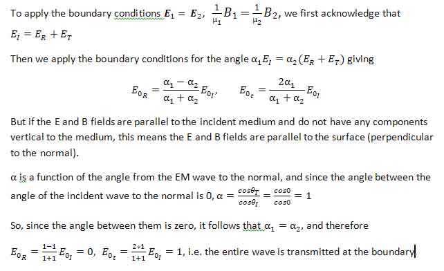

Hmmm, ok. So, then:
ER=[itex]\frac{α-β}{α+β}[/itex]EI and ET=[itex]\frac{2}{α+β}[/itex]EI where α ≡ [itex]\frac{cosθT}{cosθI}[/itex] and β≡[itex]\frac{μ1}{μ2}[/itex] [itex]\frac{n1}{n2}[/itex].
If the E and B fields are parallel to the incident medium and do not have any components vertical to the medium, this means the E and B fields are parallel to the surface (perpendicular to the normal).
α is a function of the angle from the EM wave to the normal, and since the angle between the angle of the incident wave to the normal is 0, α=[itex]\frac{cosθ_T}{cosθ_I}[/itex]=[itex]\frac{cos(0)}{cos(0)}[/itex]=1
In addition, β, which is a constant specific to how the mediums 1 & 2 affect how light travels in them, equals [itex]\frac{μ1}{μ2}[/itex] [itex]\frac{n1}{n2}[/itex] (among other things) So, more completely:
ER=[itex]\frac{[itex]\frac{cosθT}{cosθI}[/itex]-β}{[itex]\frac{cosθT}{cosθI}[/itex]+β}[/itex]EI, ET=2/[itex]\frac{}{}[/itex]((cosθT)/(cosθI )+β) EI
Then, at the boundary, if:
EI=ER+ET=[itex]\frac{}{}[/itex][itex]\frac{}{}[/itex]((cosθT)/(cosθI)-β)/[itex]\frac{}{}[/itex]((cosθT)/(cosθI)+β) EI)+2/((cosθT)/(cosθI)+β) EI)
Then: EI=[itex]\frac{}{}[/itex][itex]\frac{}{}[/itex](((cosθT)/(cosθI)-β)/[itex]\frac{}{}[/itex]((cosθT)/(cosθI)+β)+2/((cosθT)/(cosθI)+β)) EI=(((cosθT)/(cosθI)-β+2)/((cosθT)/(cosθI )+β))EI
Since (cosθT)/(cosθI)=1
ER+ET=[itex]\frac{}{}[/itex]((1-β+2)/(1+β)) EI⇒(ER+ET)/EI = [itex]\frac{}{}[/itex](1-β+2)/(1+β)=1\frac{}{}
darnit, I hit reply... hang on let me try again. Why can't I delete my own post?
Here's another way to look at it, according to some of my prof's lectures on waves on a string:
But it doesn't take into account the magnetic field. His lecture handles wavenumber and wave speed independantly, so it doesn't make sense to me how he wants for me to apply ER=[itex]\frac{1-β}{1+β}[/itex]EI and ER=[itex]\frac{2}{1+β}[/itex]EI
Should I be adding the magnetic field to the electric one?
I suppose you are familiar with Maxwell equations and electromagnetic waves. You know that both E and B are perpendicular to the direction of propagation of the wave and also to each other.
At an interface between two media, that component of the electric field which is parallel with the interface, is equal at both sides.
The same is true for B/μ.
In medium 1 from where the wave is incident, the electromagnetic field is the sum of the incident wave and the reflected one, while there is only a single traveling wave - the transmitted wave - in the second medium.
It is normal incidence as you said already, the whole electric and magnetic fields are parallel with the interface. The boundary conditions mean that
Ei+Er=Et,
1/μ1(Bi+Br)=Bt2 .
I think it was shown to you that the amplitude of the electric and magnetic waves are related as B=E/v where is v is the velocity of light in the medium, positive for a traveling wave and negative for the reflected one. Use this relation in the previous formula and solve the system of equations for Et and ER in terms of Ei .
Take care. β is incorrectly written in your first post. It has to be a dimensionless parameter: β=(μ1v1)/(μ2v2).

Well, I forgot all about B=E/v... so many eqns. OK, so I substituted E/v into 1/μ1(Bi+Br)=Bt2, but it only gets me to Er = (βEt)-Ei and Et = β(Er+Ei)
That doesn't seem close enough to the solutions in relevant equations. I substituted Er into the solution for Et and just came up with Et = β2Et, so that's clearly wrong. Did I mis-understand you? Anyway, it's clear that I'm lost. I don't know what steps to take, when I'm done, what to do next, nothing.
Ei+Er=Et
Using B=E/v transforms the second equation into
(Ei-Er)/(v1μ1)=Et/(v2μ2).
β=(v1μ1)/(v2μ2),
with that notation:
(Ei-Er)=βEt
Ei+Er=Et
Add the equations:Er cancels. Express Et in terms of Ei.
ehild
OK, I see how you got that. But why would you add them? What about the first two relevant eqns in #2? These solutions so far do not fall into that format, and if I plug in, say (Ei-Er)=βEt it does not resolve.
You have got two equations,
Ei+Er=Et
Ei-Er=βEt.
Two equation, two unknowns. Find Et and Er in terms of Ei and β.
It is simple Maths.
If you have a similar system of equations in Maths,
x+y=A
x-y=βA
how will you solve it for x and y in terms of A and β ?
ehild
Ah.
[itex]\frac{1}{μ1}[/itex]B1 = [itex]\frac{1}{μ2}[/itex]B2
[itex]\frac{1}{μ1v1}[/itex]E1 = [itex]\frac{1}{μ2v2}[/itex]E2
E1 = [itex]\frac{μ1v1}{μ2v2}[/itex]E2
E1 = βE2
Ei-Er = βEt
Subbing for Et:
Ei-Er = β(Ei+Er)
Er = Ei-βEi-βEr
Er+βEr = Ei-βEi
Er(1+β) = Ei(1-β)
Er = [itex]\frac{1-β}{1+β}[/itex]Ei
So simple! Why didn't I see it before? :confused:
I can do the other one subbing for Er.
Thanks for your patience. I was trying to get this done before the end of class but I didn't make it, so I'm hoping for partial credit. Anyway, I still wanted to solve it, so thank you for your help, I really do appreciate it.
