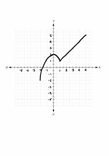

Why doesn't a limit exist at x=1? It appears that from both sides, the graph approaches 1.
See image
Sure, but not the limit as it is in the definition of a derivative: ##\lim_{h \to +0} \dfrac{f(1+h)-f(1)}{h} \neq \lim_{h \to -0} \dfrac{f(1+h)-f(1)}{h}\,.##

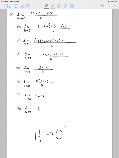

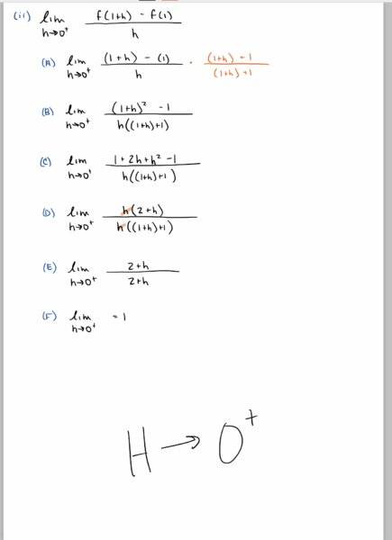

Let me see if I understand:
Using the derivative function, if x approaches 0 from the left, then x is less than 1. In this case, we use ##f(x) = -x^2+2##
Taking the derivative of this, the slope (or derivative) as h approaches 0 from the left is -2
If x approaches zero from the right, the we are greater than 1. In this case, we use ##f(x) = x##
Taking the derivative of this, the slope as h approaches 0 from the right is 1.
These individual derivates, from the left and right, are not equal, so the point at x=1 is indifferentiable.
Shown work

opus said:
Shown work
The second one looks o.k. as far as I can tell from the photo. The first one, however, looks wrong. For ##x>1## we have ##\lim_{h \downarrow 0}\dfrac{f(1+h)-f(1)}{h}=\lim_{h \downarrow 0}\dfrac{1-1}{h}=0## since the nominator is equally zero and the denominator only approaching it. There is no ##\frac{0}{0}\,.##
Likes opus
For the second, as you had shown, I tried some voodoo by multiplying by the conjugate of the numerator to the top and bottom. In doing this, I got the limit as 1 and that made sense because to the right of one, it's the line y=x.
Without doing this however, I did get the limit to be 0, but that doesn't make sense at all by looking at the graph. Could you explain?
Sorry, my fault. I mistakenly took ##f(x)=1## for ##x>1## instead of ##f(x)=x##. Here's the correction:

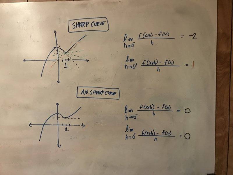

So does this make sense? Trying to visualize this.
In the top graph, the limit of the derivative from the left is -2 and from the right is 1. AT x=1 it gets wonky because there’s not a smooth transition.
In the top graph, which is a somewhat equivalent, there is a smooth transition so the different slopes on each side of x=1 converge on a derivative or slope of 0.
Yes, this makes sense. For short: ##x \longmapsto |x|## is not differentiable at ##x=0\,.## whereas ##x \longmapsto x^n## are.
