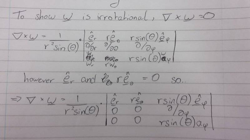

I started by finding vector potential. however it seems too simple. (Or most likely id id it wrong). In addition i am not sure, if it is even the right way to about it. I can't put in working out of the vector potential i have, as i have trouble with coding it on the forum(My handwriting is not legible). So you can assume i have got it wrong. Any help will be greatly appreciated.

I have figured out part 2, very similar to part one. Cross multiply the matrix, and we get 0. I think I am getting somewhere on part three as well. Thank you. And your LaTeX skills are too good xD
MMMM... I think you got that rotational wrong. You cannot cancel those partial derivatives inside the determinant.
Those vectors aren't zero, but their associated components.
Also I think you haven't understood the exercice. It doesn't demand you to show that is irrotational, but to assume it is in order to find out what is the function of the phi component.
Likes YogiBear
Of course. I rushed to conclusion without reading question fully...
thanks for the help thought, i would have had it completely wrong otherwise.
