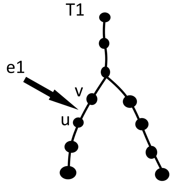

Let's say for intuition, ## T_1 ## looks like this:
where ## e_1 = \{ v ,u \} ##.

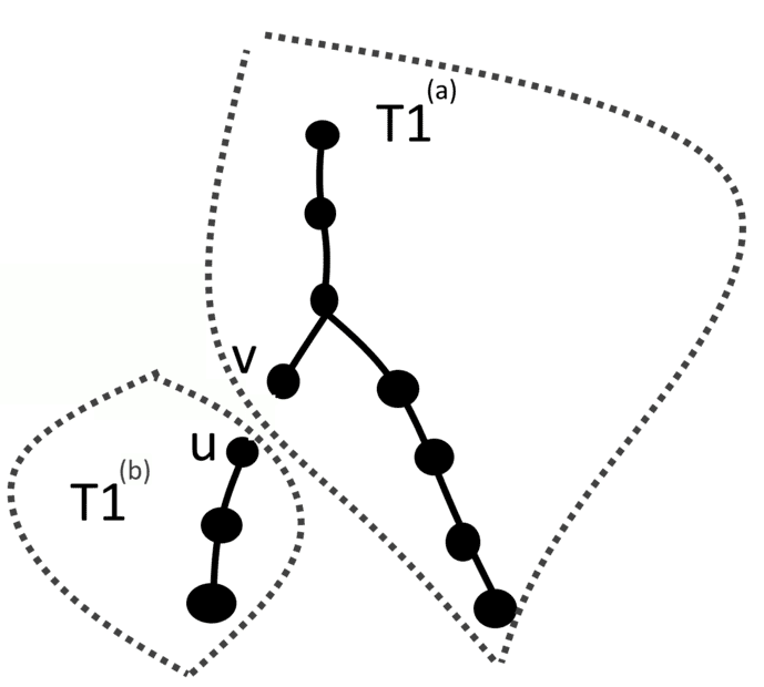

After taking the edge out of the graph we get two subtrees for ## T_1 ## which I denote ## T_1^{(a)} ## , ## T_1^{(b)} ##:
But I'm having difficulty seeing how ## T_2 ## plays a role here.
Does there have to be an edge in ##T_2## that connects a vertex in ##T_1^a## and ##T_1^b##? I think the answer is yes.

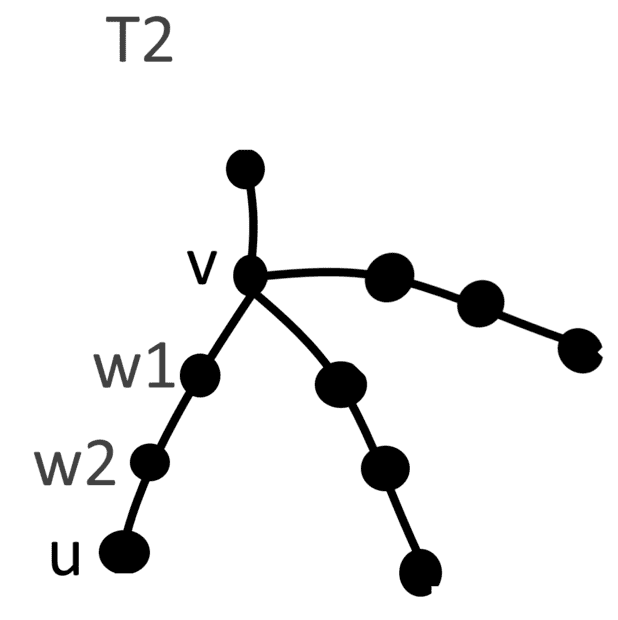

Yes you are right. Here's an example of what ## T_2 ## could look like
I'll pick edge ## { w_1,w_2} \in E_2 ## and add it to the gap after the split in ## T_1 ##, so ## T_1 ## would look like:
and we denote this new tree as ## T_1' ## , we do the same process to get ## T_2' ##
In your forest of ##T_1^a## and ##T_1^b## u and v both had degree one. You were then supposed to add an edge that did not connect u to v, so at least one of them should be a degree one vertex in ##T_1'##. Hence I think your picture can't be correct.
I'm not really sure how ##T_1## and ##T_2## are supposed to lay on top of each other, like which vertices in each graph match to which vertices on the other?

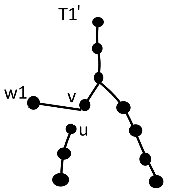

So ## T_1' ## ( after creating only one edge which leaves ## u ## with degree 1) should look like this?:
##w_1## there is a totally new vertex you just added to the picture. It has to be a vertex that already existed.
I think you should label every single vertex in the picture of ##T_1## and give the same labeling to the picture of ##T_2##. Then you can see where ##w_1## and ##w_2## actually are in the ##T_1## picture. You may or may not have picked the right edge, your picture so far is not sufficient to know if ##\{u,w_1\},\{w_1,w_2\}## or ##\{w_2,v\}## is the right edge.

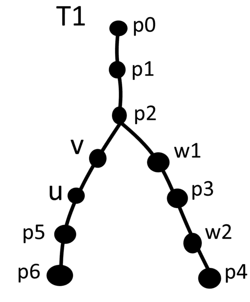

Ok, I labeled the graphs:
I still don't fully see which edge I can take in ## T_2 ## that will connect me ## u,v ## After I split the edge between them in graph ## T_1 ##
When you remove ##u,v## from ##T_1##, to reconnect the trees you need to find an edge from the set ##(u,p_5,p_6)## to the set of the other vertices.
##p_5,p_2## would work. So would ##p_5,v##. So would ##u,w_2##. ##p_6,p_2## would also work.
The main point is that since ##T_2## is a tree, I claim there is at least one edge that connects these two groups of vertices.

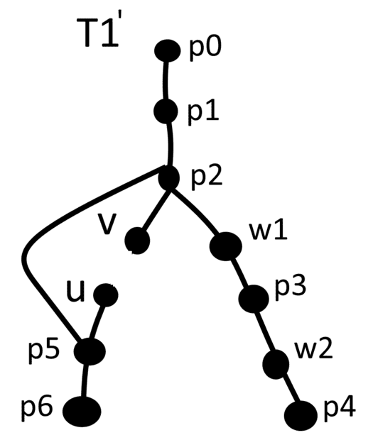

Ok I think I got the intuition, here's an example of what ## T_1' ## could be based on the last two images above:
