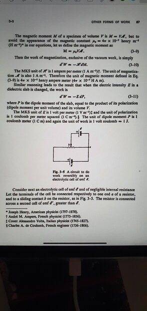

This is exercise 3-12 form Sears and Salinger Thermodynamics : Show that $$\delta W = -E dP$$ by calculating the work necessary to charge a parallel plate capacitor containing a dielectric.
$$W = U = \frac{q^2}{2C}$$
$$ C = \frac{\kappa \epsilon_0 A}{d}$$
$$P = qd $$ (dipole moment of slab)
$$ E = \frac{q}{\epsilon_0 \kappa A}$$
$$W = U = \frac{q^2}{2C} =\frac{q q d}{2 \kappa \epsilon_0 A} = \frac{E P}{2}$$
Then , since E is constant we have that :
$$\delta W = \frac{dW}{dP} dP = \frac{E}{2} dP$$.
My question is how can I make this 2 on the denominator disappear in order to obtain the required expression ?
ps : In the book (Chapter 3 page 67) he mentions that $$\delta W$$ is the work when $$E$$ is changed in a dielectric slab.

I think q is changing, since the work is done to change E.
