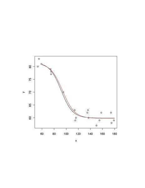

I model arterial baroreflex data that I have collected in humans using the Kent equation which is:
y=p1/(1+exp((x-p3)*p2))+p4; where Y=heart rate, X= estimated carotid sinus pressure, p1=range of Y, p2=slope coeff, p3=centerpoint on X, p4 = minimum Y.
I use Sigma Plot to do a best fit line on the points I have collected. The points are actually in six groups of 3 with one point which is the operating point. out of all of those points, the only one i know the gain at for sure is the single operating point.
What I would like to know is: Is there any way to force the best fit line through a point which I have the coordinates and a gain that the line should have while passing through that point.
Attached is a test file graph that explains my problem. the line fits the points with r^2 =0.966 but it does not go through the point (95,70) at a gain of -0.54, which is the only point and gain which is constant. Anybody know how to force fit the line to the point in Sigma Plot?

I suppose with gain you mean the slope?
First note that it is not possible to estimate p2 and p3 independently from the data but only the product p5= p2*exp(-p3).
Then when you know dy/dx at some point you can solve this equation for e.g. p1 and eliminate it from the equation which relates y to x, p1, p4 and p5.

I think I understood your question, although I am not sure whether you understood the solution I was proposing.
I don't know Sigmaplot, but I don't think that's relevant. What you want to do is to find a solution which obeys an auxiliary condition, namely that it's slope at a given point has a given value.
I recommended to include this information explicitly in the equation by elimination of one of the parameters before doing the optimization.
Another method would be to use the technique of Lagrangian multipliers. maybe something of this kind is implemented directly in Sigmaplot.

Add this as your constraint by setting RHS to -0.54 at x=95:
Actually the slope and pass-through-point constraint give you two independant eq. in (p1, p2, p3, p4).
Using algebra, can't you restate the model in just 2 variable and then use the fit function?
Do you see what I mean?
The algebra seems a bit messy for the slope constraint though.
i.e.
p4=70-p1/(1+exp((95-p3)*p2))
and
p1={ 0.54*[exp(p2*p3)+exp(p2*95)]^2 } / {p2 * exp(p2*(p3 + 95)) }
So now fit in SigmaPlot the following fn but only for p2 and p3.
y=[{ 0.54*[exp(p2*p3)+exp(p2*95)]^2 } / {p2 * exp(p2*(p3 + 95)) }]/(1+exp((x-p3)*p2))+70-p1/(1+exp((95-p3)*p2))
Messy, but you put the constraints on and not me. :)

Its likely I did an algebra blunder. Verify my rearrangements.
The red line looks right?
Larger image here:
http://i.imgur.com/qoxSAo8.jpg
Verification:
predict(fit1,list(x=95))
[1] 70
(predict(fit1,list(x=96))-predict(fit1,list(x=94)))/(96-94)
[1] -0.5395504
PS. I used R instead; didn't have Sigmaplot handy.
It was a mistake. Left a p1 unsubstituted.
Try fitting this in Sigmaplot for p2 and p3.:
y=(( 0.54*(exp(p2*p3)+exp(p2*95))^2 ) / (p2 * exp(p2*(p3 + 95)) ))/(1+exp((x-p3)*p2))+70-(( 0.54*(exp(p2*p3)+exp(p2*95))^2 ) / (p2 * exp(p2*(p3 + 95)) ))/(1+exp((95-p3)*p2))

Sure. It was an interesting problem; hence my motivation. :)
Try R:
Code:
fit<-nls(y~p1/(1+exp((x-p3)*p2))+p4,start=list(p1=20,p2=0.1,p3=90,p4=50))
 summary(fit)
  plot(x,y)
  tt<-seq(60,180,length=100)
  lines(tt, predict(fit,list(x=tt)))
fit1<-nls(y~(( 0.54*(exp(p2*p3)+exp(p2*95))^2 ) / (p2 * exp(p2*(p3 + 95)) ))/(1+exp((x-p3)*p2))+70-(( 0.54*(exp(p2*p3)+exp(p2*95))^2 ) / (p2 * exp(p2*(p3 + 95)) ))/(1+exp((95-p3)*p2)),start=list(p2=0.1,p3=90))
lines(tt, predict(fit1,list(x=tt)),col=34)
[1] 70
[1] -0.5395504

I think the current formulation is pretty dynamic. Just replace 95 by x_OP,70 by y_OP and -0.54 by s_OP
The rest should be the same.
I'm telling you, it'll be a breeze in R. :biggrin:
PS. I'm no R loyalist. I believe in whatever works. Had tried Python on your problem at first but didn't get far.
