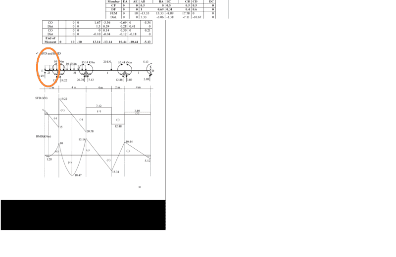

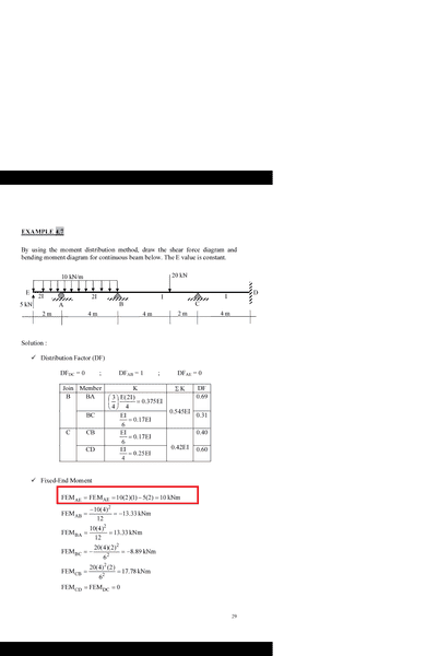

I don't understand why the fixed end moment at AE is 10KNm ( clockwise) .
Forger about the sign convention here , i have the resultant moment = 10KNm , which ic clockwise , why in the 2nd picture ( SFD and BMD part) , the moment is anticlockwise ?
The moment at AE= 5(2) - 10(2) = -10(anticlcockwise) , why it's clockwise as shown in the diagram in the 2nd picture?

You must sum moments equal to 0 for equilibrium, so when drawing a free body diagram of AE and summing moments about the cut section at A, the applied loading is 10 kNm anticlockwise, so the moment in the beam at A in that diagram must be 10 kNm clockwise.
In terms of normal sign convention, clockwise moments acting on a left hand section are negative (hogging moments, beam bending convex downwards ), but unfortunately, the author drew the moment diagram unconventionally; it should me mirrored for conventional signage.

Do you mean that to produce sum of moment = 0 , the moment should counter The moment at AE= 5(2) - 10(2) = -10(anticlcockwise) , so , the moment is clockwise ?

I'm not sure what the author is stating. The internal moment at A acting on Section AE is clockwise. The picture is confusing I think. Clockwise moments acting on left hand sections are negative, by convention. But the author goes against convention when drawing the moment diagram, and shows the moment as positive. You can argue that being unconventional is ok, but it is wrong as far as I am concerned, because it does not follow the calculus of dM/dx = V

Since internal moment = reaction moment , so at left of A , the moment resultant = 10Nm anticlockwise , reaction moment has to be 10NM clockwise, in order to satisfy the equilibrium requirement that the sum of all moments about any point must equal 0.
