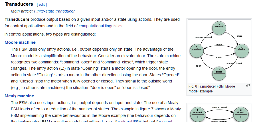

To do this right, you need to consider using Finite State Machine (FSM) techniques, IMO. Have you been exposed to them before?
https://en.wikipedia.org/wiki/Finite-state_machine
Yeah as I mentioned in my original post my first idea was basically a FSM.
For the nice clean signals, such as the first one I listed, this should work well I expect, however ideally I'd like it to handle less ideal signals as well, such as the second one. I was not sure I'd be able to get the state machine to reliably recognize those, but maybe focusing on the raw signals would be better for a FSM.
