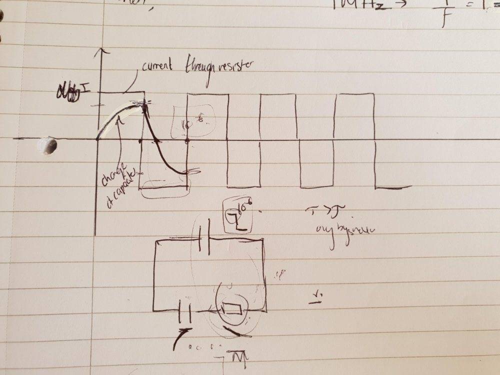

I started by working out the time constant of the Capacitor = RC = 300 * 1.5*10^-9 = 0.45 *10^-6
and the time period (t) of the square wave signal produced by the signal generator : 1/(1*10^6 )= 10^-6
Then I drawed the graph as follows:
https://www.physicsforums.com/data/attachments/234/234320-391937ca3e0804dfc6126d030d757447.jpg I sketched what I thought the circuit was for this Q below the graph. I unsure how the graph of the capacitor would look like for when the voltage applied by the singal generator is negative.
T /2 is roughly equal to one time constant so on the graph, at T/2 I showed the Chargge/Voltage/current of the capacitance at 63% roughly of the p.d applied across the capactior and the resistor.

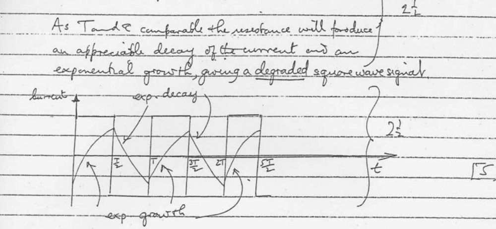

However the worked solutions below show a different graph, along with some of the reasoning.
https://www.physicsforums.com/data/attachments/234/234321-6a47ec112bdd2f8099738f570ac71db3.jpg
1) I'm really confused on the reasoning given for the graph for the capacitor shown in the solutions, and thus I can't understand the graph. If it could be explained more clearly I would be grateful.
Also, Q1) Why does the graph of the capactior start at a negative value at t=0 , surely it would have no charge on its plates intially?
12) Am I correct that the capacitor, when the voltage is reversed by the signal generator, after T/2, the capactior reaches the same magntiude of charge (on its other plate this time) , but in a smaller time than the time constant - as in the reverse direction, the current reaching the capactior plate would be greater due to not having to go through the resistor.
Same differential equation: the current flows the other way. Resistor is still sitting there ! So:
Not correct.
Note that your solution -- if continued for a few more cycles -- and the worked solution are as good as equal:
User1265 said:
Also, Q1) Why does the graph of the capactor start at a negative value at t=0 , surely it would have no charge on its plates intially?
Because that's what you get to see on the oscilloscope: the periodic part of the solution.
You are correct with your analysis (assuming the exercise actually mentions the initial state of the capacitor -- which it does not) but is a transient solution that lasts only for a few microseconds

Thanks for the clarification. May I ask why my thinking is not correct for this part?
If the voltage inside the signal generator is negative, the current still has to go through its internal resistance of 300 Ohm.
Consider the diagram of a short-circuit situation and then turn it upside down
Likes User1265
You can get an exact output waveform expression with the following approach and fact:
1. Peak-to-trough time = trough-to-peak time = 1/2 the period of the input square wave.
2. Assuming say +/- 1V input square wave, write the expression for the output voltage starting at the (unknown) negative-most voltage and aiming for the positive-most voltage. During this time the excitation voltage is +1V.
After 1/2 period the output voltage is at peak and its magnitude is the same as that of the trough voltage.
That's it, you should be able to take it from there.
