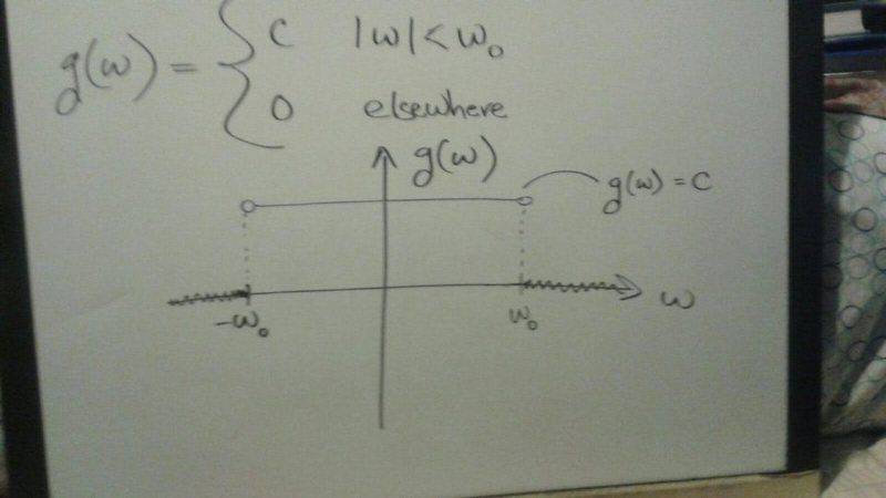

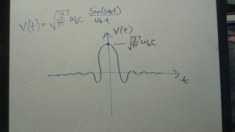

Assume a wave packet is has contributions from various frequencies, give by g(ω)=C for |ω|<ω0, and g(ω) =0 for elsewhere.
a)What is the signal strength as a function of time, i.e., V(t)=?

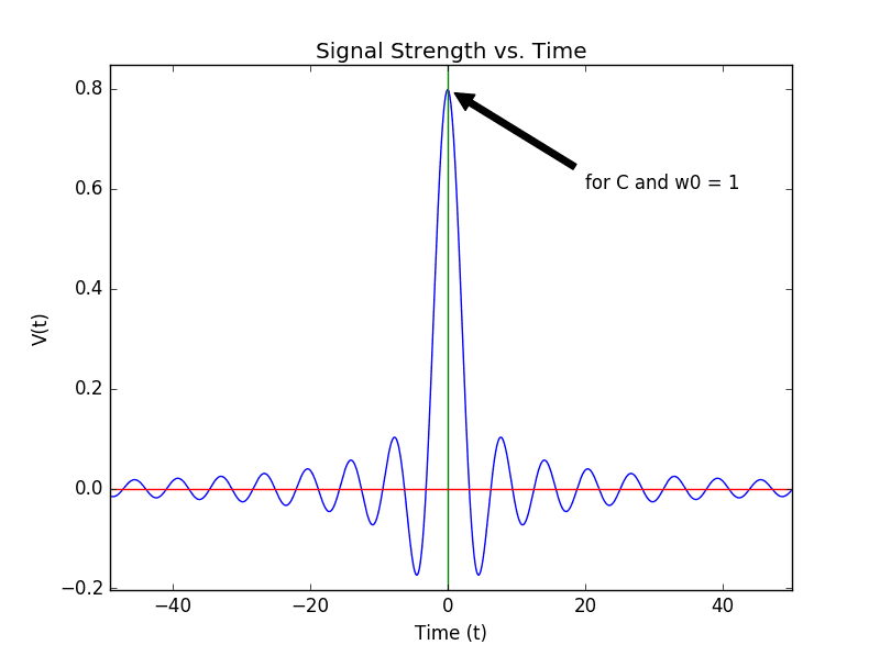

b) Sketch g(ω) and V(t); You can use fooplots.com, for example, or python.
c) Indicate Δω and Δt in the above plots; Does the products of these two satisfy ΔωΔt>1/2?
V(t) = 1/√(2π) * integral from -∞ to +∞ of [ g(ω)*exp(iωt)] dω
exp(iωt) = cos(ωt) + isin(ωt)
a.) V(t) = 1/√(2π) * integral from -ω0 to +ω0 of [ C*exp(iωt)] dω
using eulers formula and the properties of even and odd functions
V(t) = 2/√(2π) * integral from 0 to +ω0 of [ C*cos(ωt)] dω
V(t) = 2C/√(2π) * sin(ω0t)/t = √(2/π)*ω0C * sin(ω0t)/ω0t
b.) the sketches for g(ω) and V(t) are in the attachments
c.) I am not really sure what Δω and Δt in these graphs
Shouldn't the lower integral limit be ##-\omega_0##?
Use the definition of standard deviation. For example for V(t), you will use
\Delta t = \sqrt{E[t^2]-(E[t])^2}
where ##E[\,\,]## means taking average over the intensity ##|V(t)|^2##. Similar arguments for ##g(\omega)##.
blue_leaf77 said:
Shouldn't the lower integral limit be −ω0−ω0-\omega_0?
I have a factor of 2 in the front to account for that. Is that not right?
Ah sorry I missed that, you are right.
