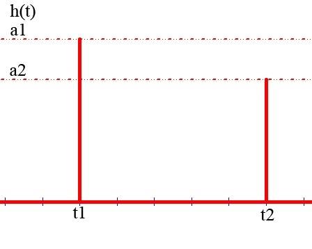

The system with impulse response [tex]h(t) = a_{1}\delta(t-t_{1}) + a_{2}\delta(t-t_{2})[/tex]. Is this system stable or not?
I drew the h(t) response and I got something like that:
but I don't really know how to prove it. There is no input give, only input response.
I would say that it is iff [tex]-1\leq a_{1} \leq 1[/tex] & [tex]-1\leq a_{2} \leq 1[/tex], since for this values input (if it was a unit step, say) would be bounded, thus producing bounded output. I.E. BIBO stable. Is that right?
Thanks guys!
Write down the output of this system for an arbitrary input x(t). Is the output bounded if the input is finite?

No, the integral of a delta function is one so long as the interval includes the point at which its argument is zero. In the case you gave, the delta function is zero except at tau=t, but this is in the interval -inf to +inf so
[tex]
\int_{-\infty}^{\infty}\delta(\tau-t)d\tau =1
[/tex]

If you are integrating from -inf to +inf, the offset is irrelevant. Change variables u=tau-t and evaluate the integral, to prove it to yourself.
