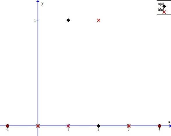

Input and system response is as follow:
[tex]x[n] = r[n] - 2r[n - 1] + r[n - 2][/tex]
[tex]h[n] = \delta[n - 2][/tex]
The output is:
[tex]y[n] = u[n - 3][/tex]
Is that true?
I draw the h[n] and x[n] and they looked as follows:
As for me when these two are multiplied, it will become [tex]y[n]=0[/tex].
Am I right?
Thanks
Can anyone give me a tip maybe? Thanks!
