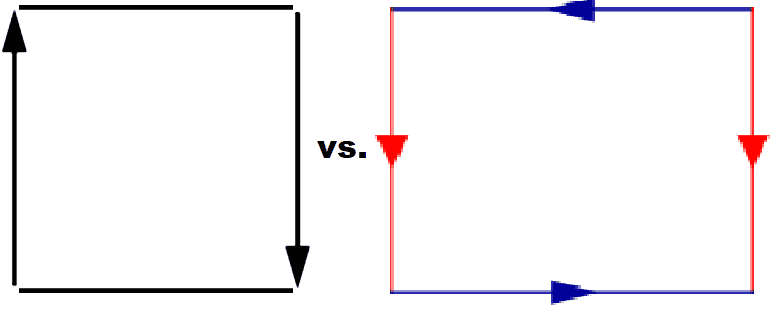

You do the same as in real life: Cut out a square and glue it to a Möbius strip.
Now comes the difference: In real life, we cannot leave our three-dimensional space, and the paper remains three-dimensional. In mathematics, however, a square is ##[0,1] \times [0,1]=[0,1]^2## which is two-dimensional, and the gluing becomes an equivalence relation, i.e. identifying twisted opposite points.
Whether the abstract procedure qualifies for existence or not until we use paper is a matter of taste and in any case philosophy.

One might take the description in post #26 of the Möbius band as a square with two opposite edges identified with a reflection and ask how a flatlander living on it would discover that his world is non-orientable.
There must be a way for the flatlander to figure this out because non-orientability is an intrinsic feature of the Möbius band and is independent of how it is realized whether in 3 space or in a Klein bottle or anywhere else.
The unit normal in 3 space is not available to the flatlander. Non-orientability must detected from within the Möbius band.
What even does this idea of intrinsic non-orientability mean?
Flatlanders don't live on a 2D surface, they live in a 2D surface. A left-handed flatlander living in a cylinder will always be left-handed: if it were possible to be a left-handed flatlander living in a Möbius band then they could become right-handed by traversing the band (and hence there can be no such thing: at what point on the band would they switch hands?)
