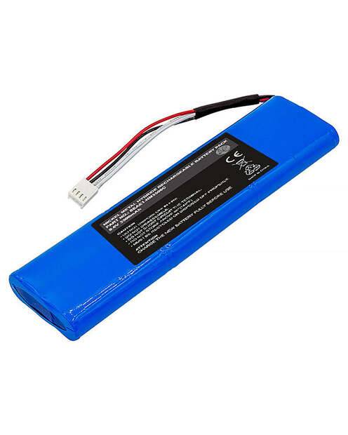

See this pack , originally got 8 custom size batteries in series but I am trying to fit similar size with 14 AA 1.2 ni-mh Varta cells , and of course with max current.
badr said:
I am looking for 9.6 volts , and i only got 14 ni-mh cells of 1.2 volts each. ... See this pack
That pack is in the size/performance which can explode/catch fire, so the tutorial mode should end here I think.
You may be able to get a pro who can make the pack from the usual 4/3AF NiMh cells and that'll just work perfectly.
Cheap replacements from Ali or such should do the trick too.
You are clearly not at the right level, so the whole DCDC thing is just off the table. Forget it.

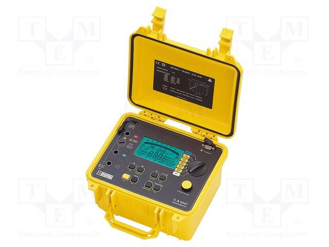

This battery is for powering this megohmmeter :
A new battery costs a lot.
So that product comes with an internal rechargeable battery and charging circuit, but you want to convert it to use an external rechargeable battery with your own recharging circuit?
Why would you be so concerned with "maximum current" for a device like that? It shouldn't draw much current, I think.
