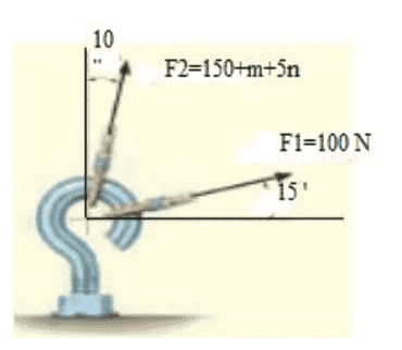

In summary: The resultant force is F2 = 150+m+5n, where m and n are unknown.In summary, the screw eye is subjected to two forces, F1 and F2. F1 is a force of 120 newtons at an angle of 10 degrees, and F2 is a force of 187 newtons at an angle of 80 degrees. The resultant force is F2 = 150+m+5n, where m and n are unknown.

The screw eye is subjected to two forces, F1 and F2. Determine the magnitude and direction of the resultant force.
Hi, :welcome:
The pf guidelines require that you post an attempt at solution ...
Can you find the components of the two forces?

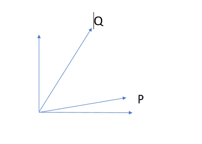

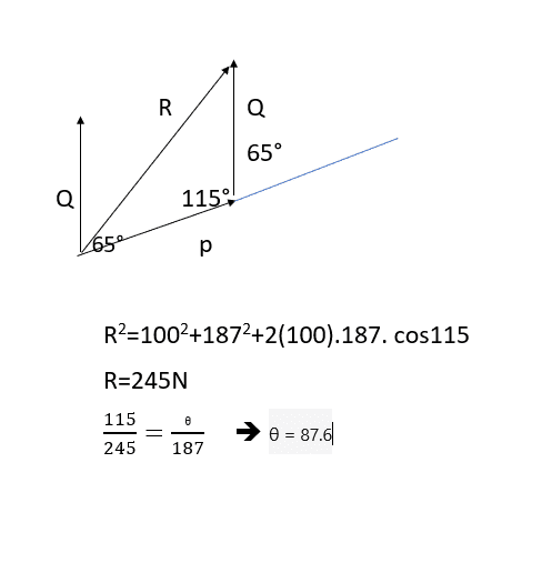

Hello,
I know this way to solve
R2=P2+Q2-2pQ CosB
Then our B is 115 degree
But our Q is unknown
sHatDowN said:
Hello,
R2=P2+Q2-2pQ CosB
Please state how you are matching up p, q, r to the diagram.
Likes BvU
And R is resultant
:smile: Nice, but that does not answer @haruspex 'question ...
How does one interpret the label F2 = 150+m+5n in the drawing?
Likes Lnewqban and nasu
sHatDowN said:
And R is resultant
Have you quoted the whole question? Is there no explanation of what m and n are?
m=12
n=5
I find out answer like that :
R=245N
θ=87.6
sHatDowN said:
m=12
n=5
R=245N
θ=87.6
Can you show your work for that? I get a different answer.
Edit: Unlike @haruspex, I get something a bit larger for R and something very different for ##\theta##. I am taking theta to be the angle in the first quadrant where the resultant lies.
[Calculated twice. Once with paper and pencil and calculator, a second time writing a program using same algorithm. Same answer both times -- once I remembered to convert to radians and back]

I get a slightly smaller answer for R, but how are you defining θ and how are you calculating it?
actually θ is between P and R
and 65° is between P and Q
sHatDowN said:
That last equation appears to be a misremembered version of the sine rule.
The question does not specify what direction to measure the angle from, but it would be unusual to measure it from one of the applied forces. You should measure it the same way the given angles are measured, i.e. from one of the axes.
Edit… and your cos rule equation cannot be what you meant. It's either minus at the end or cos(180-115).
Then why are you using 115 instead of 65?!
How did you manage to get a near correct answer out of an incorrect formula? Using 115 degrees instead of 65 should have yielded a result of 170.77

I do not comprehend your calculation for theta at all.
I solved exact like this
It's Come from sin law
In post #12 you wrote ##\frac Aa=\frac Bb##, but I assume that was just a typo.
As I indicated, the question setter would be expecting the direction to be specified as measured from one of the axes, like the 10° and 15°are, not from P.
Likes sHatDowN

In post #12 you wrote ##\frac{115}{245}=\frac\theta {187}##, instead of ##\frac{\sin(115)}{245}=\frac{\sin(\theta)} {187}##. I assumed it was a typo, but it seems you actually used the misstated version.
The question setter gave you angles relative to two axes at right angles. Your answer for the direction of the resultant should also be relative to one of those two axes. The way you tried to use the sine rule, had you used it correctly, you would have found the angle between P and R. So you should then have added 15° to get the angle between the axis and R.
[... converting graphic to ##\LaTeX##...]
$$R^2 = P^2 + Q^2 - 2PQ \cos \theta$$
In this formula, ##\theta## is taken to be the angle formed between the head of the one vector and the tail of the other. So that parallel vectors will form an angle of 180 degrees.
The way I would measure the angle between two vectors is tail to tail so that parallel vectors will form an angle of 0 degrees. Accordingly, the formula that I would use would be$$R^2 = P^2 + Q^2 + 2PQ \cos \theta$$
This explains how you were able to obtain an approximately correct magnitude from an apparently incorrect angle. Round-off error explains the discrepancy between your 245 N and a more accurate figure of 247 N.

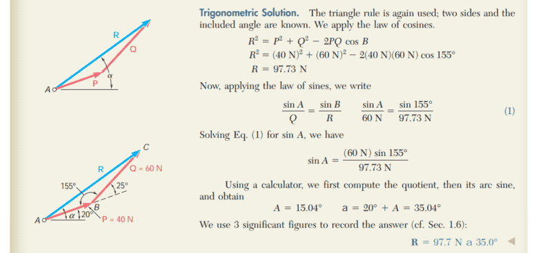

Now then, on to your calculation for ##\theta##. You have given two formulas for ##\theta##. The first is the one that you claim to have used:$$\frac{115}{245} = \frac{\theta}{187}$$You are dividing one angle by a length and then equating that to another angle divided by another length. That is not justified.
As a justification for this, you call upon something that you call the "sin rule":$$\frac{\sin A}{a} = \frac{\sin B}{b} = \frac{\sin C}{c}$$This law holds for a triangle with sides of length a, b and c and angles opposite these sides equal to A, B and C respectively.
The problem is that the law of sines does not divide an angle by a length. It divides the sine of an angle by a length. If you use the law of sines, you need to use sines. [If you were trying to invoke the small angle approximation, it only works for small angles].
The result that you get from the calculation that you claim to have performed is 87.5 degrees. You claim that this angle is measured (counter-clockwise?) from the angle of force ##F_1##. That would put the resulting direction somewhere in the second quadrant.
You cannot add two vectors that are both in the first quadrant and expect a result in the second quadrant.
