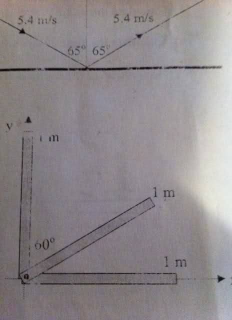

Hey all. Below is the question and picture related to it.
"Three uniform metre sticks each of mass M are attached together as follows: Stick 1 lies along the y-axis from y = 0 to y = 1.0m. Stick 2 lies along the x-axis from x = 0 to x = 1.0m. Stick 3 makes an angle of 60 degrees with the y axis. Find the x and Y coordinates of the centre of mass of the system of three metre sticks, and marks its approximate location on the diagram of the three sticks."
----Sorry, its kinda upside down :)
I am really confused with this one.
Maybe let's start with the X
The formula I know is: Xcm = m1x1 + m2x2 + m3x3 / m1+m2+m3
But how do I input into this formula... ??
Replace every metre stick with a point mass of M at its own centre of mass.

How do I find each metre sticks own center of mass??
assuming each stick is of uniform density, it will be in the physical center of the stick.
[itex] x_{c} = \frac{\sum_{i = 1}^{N} m_{i} x_{i}}{\sum_{i = 1}^{N} m_{i}} [/itex]
[itex] y_{c} = \frac{\sum_{i = 1}^{N} m_{i} y_{i}}{\sum_{i = 1}^{N} m_{i}} [/itex]
these describe the center of mass, but assuming it is uniform, the masses are taken out and you are left with just the physical center:
[itex]x_{c} = \frac{\sum_{i=1}^{N} x_{i}}{N}[/itex]
[itex]y_{c} = \frac{\sum_{i=1}^{N} y_{i}}{N}[/itex]
now plug that into the same equation for all three sticks:
[itex]x_{cm} = \frac{x_{cm1} + x_{cm2} + x_{sm3}}{3}[/itex]
[itex]y_{cm} = \frac{y_{cm1} + y_{cm2} + y_{sm3}}{3}[/itex]

What about the stick at the 60 degree angle?
Im actually having trouble with plugging the right info into the formula, let's say for X - what would let's say "Xcm1" be?
You can resolve the center of mass of the angled stick into its components using trig ratios.
[itex] x = \frac{1}{2} \cos (\frac{\pi}{6})[/itex]
[itex] y = \frac{1}{2} \sin (\frac{\pi}{6})[/itex]
and then proceed from there.
by [itex]x_{cm1}[/itex] i mean the x component of the center of mass for stick one.
is Xcm1 = .5 m?

well that depends on what you choose to be your first stick. if you're talking about the bottom one then you'd be correct

keep trying, but you can check it against this:
[itex]x_{cm} = \frac{0 + \frac{1}{2}\cos(\frac{\pi}{6}) + 0.5}{3}[/itex]
[itex]y_{cm} = \frac{0.5 + \frac{1}{2}\sin(\frac{\pi}{6}) + 0}{3}[/itex]
Gordon or anyone, here is what I got. Can you tell me if the answer I got to this question is correct, including image (posted below)
(.333 i + .168 j) m
Image of where centre of mass roughly would be?
Can anyone confirm this for me please ? :)
Two words my friend, radian mode.
dammit :)
How about now:
0.31i, 0.25j
Is that correct?
yup, now i'd suggest going over the problem again or making up your own problem simmilar to this one to practice.
