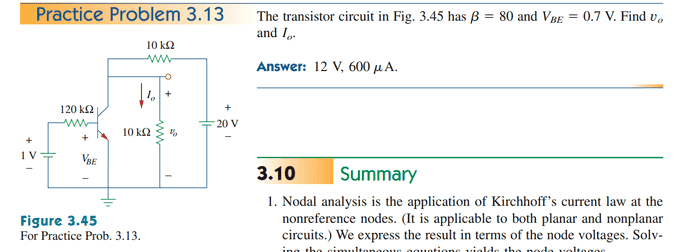

All loops are clockwise;
KVL Loop around 1V, 120kOhm and VBE (I1 is assigned to the loop):
-1V + 120kOhm * I1 + VBE = 0
I1 = IB = 0.3V / 120kOhm = 2.5 * 10-6 A;
Loop around 10kOhm, vCE (I2 is assigned to the loop);
KVL Loop around 10kOhm, vo, and 20V (I3 is assigned to the loop):
10kOhm * I3 + 20V - vo = 0
vo = 10kOhm * (I2 - I3)
10kOhm * I3 +20V + (I3 - I2) * 10kOhm = 0 (1);
At the node connecting the collector part of the transistor, Io and 10kOhm:
I3 + (I2 - I3) + IC = 0
since Io = I2 - I3

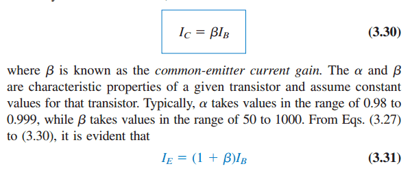

IC = B * IB = 80 * 2.5 * 10-6 = 2 * 10-4 A
I2 = -2 * 10-4 A (2);
Subbing (2) into (1):
10kOhm * I3 +20V + (I3 + 2 * 10-4 A) * 10kOhm = 0
20kOhm * I3 = - 20V - 2 * 10-4 A * 10kOhm
I3 = -22 / 20k A = -1.1 * 10-3
I2 - I3 = 9 * 10 -4 A ! = 6 * 10 -4 WRONG
And I've been stuck redoing the same equations for a day now... Would be nice if someone could help find the problem in my "solution" so I can finally move on haha.

The given values of Vo and Io do not follow Ohm's law.
I am also getting Io=9*10-4 A.

The given answers are 12V and 600uA, which are incorrect. They don't follow Ohm's law.

Collector current Ic=2x10-4A.
Using KVL you can write,
104*Io=20-104*(Io+2*10-4).
Solving this for Io, we get Io=9×10-4 A.

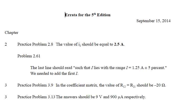

Oh actually I've made a big fuss for nothing! I've just look at the author's errata and the answer is indeed 9 * 10 -4!
