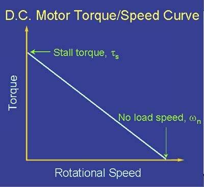

Ok, so I'm doing an experimental write up for an experiment on adjusting voltage on the speed of a simple DC motor, and changing the number of coils.
I thought that I understood what I was saying but I've recently become a little confused with the concepts of torque vs speed specifically when trying to talk about a torque/speed graph.
I know that as torque increases, speed decreases, but I've also been talking about EMF and Faraday's law todo with how as the motor increases in speed the current drops until the torque is quite small (Due to the equation τ=BAIN cosθ, τ=torque, B = magnetic field, A = area of coil, I = current, N = number of turns) and then the forces are equal as the small torque remaining is balanced due to friction, and also the magnetic field working against the motor that has been produced as it cuts the magnetic field (this is faradays law correct?)
So what I'm not sure about is, do I say that as the number of coils increases, the torque increases (due to the A and N in the above equation) and as such the speed is reduced, or Is it more technically that as the number of coils increases, the generated back emf is larger, and also the magnetic field produced by this back emf is larger, which also causes it to be slowed.

An idea lossless DC permanant magnet motor running flat out with no load draws no current and generates no torque. If there was torque it would keep accelerating.
When you apply power to one of these motors it accelerates until the back emf matches the supply voltage. The back emf is proportional to the number of turns so the more turns the lower the rpm at which the back emf is equal to the supply voltage. This is why more turns => slower motor.
This page and graph might help...
http://lancet.mit.edu/motors/motors3.html
This is the torque vs speed for constant voltage and constant number of turns...
This sort of plot is produced by putting the motor on a variable load/brake. eg The speed is being forced to change and the torque measured.
Note how at max speed the torque is zero and when stalled there is a max torque.
If you increase the number of turns the slope gets steeper.
PS When thinking about Torque vs Speed it matters what is causing the speed to change. eg is it the load, the supply voltage or the number of turns you are changing. The effect on the plot for torque vs speed is different in each case.

Ah I see the confusion. You are wondering why increasing the torque doesn't increase speed.
The torque produced by a motor is not a constant it's a curve (Edit: Well a straight line). It's missleading to say that increasing turns increases torque. You can only say that it changes the torque curve. The actual torque produced at anyone time depends on the load.
The no load (no torque) speed will reduce. The max torque (no speed) will increase. You might not have been changing the load but what was the load?

I would save a copy of that plot I posted above. Then add two lines showing what happens when you increase or reduce the number of turns. eg work out what happens to the no load speed and stall torque and join with a straight line. Need not be 100 to scale.

When you draw the chart you will see that the lines cross so as you change the number of turns at some loads (some torque) the speed is higher and at others it is lower.
