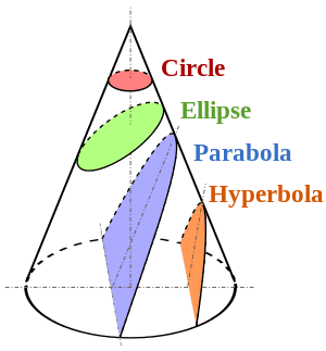

Thanks for the reply. Okay, I just did something I would have done the other day I was on PF if I'd have had the time, which was to wiki 'parabola'. It has been a long long time since I'd thought of parabolas in a non-trivial way (I basically just remembered locus and focus). The same thing almost goes for integration :P
Anyway, the picture of https://upload.wikimedia.org/wikipe...rabeln-var-s.svg/330px-Parabeln-var-s.svg.png
as was the family of conic sections. Basically a parabola is a graph of a quadratic function. So what I meant in my last post, was 'what [sort of] quadratic equation.

So does this mean that the [type] of parabola y = x2 with no 'a' coefficient or +/- 'constant' ?
What you quoted was about a part that is not a parabola.

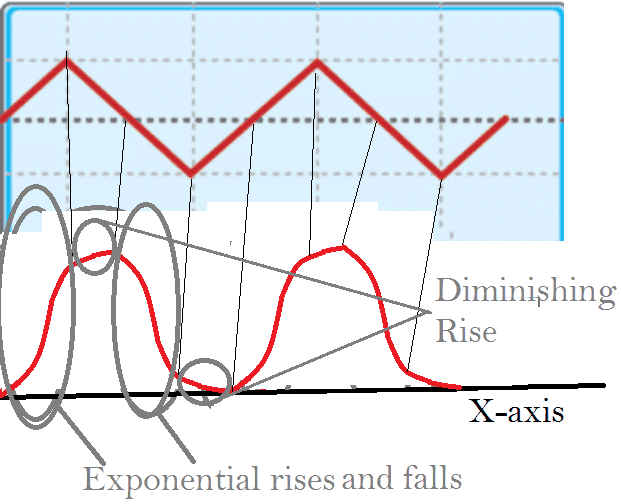

Also, according to
http://www.embedded.com/electronics-blogs/programmer-s-toolbox/4025567/Rosetta-Stone-explained

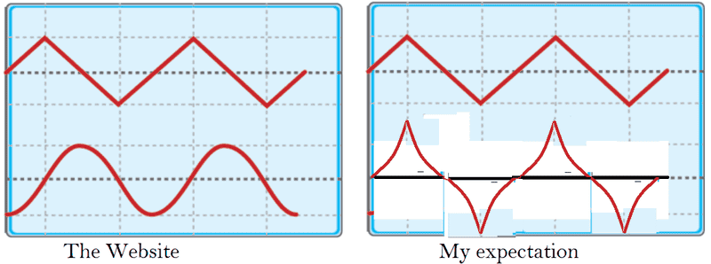

This is what the integral of the triangular wave looks like, also in the attached picture is what I would have expected it to look like:
I assume I'm mistaken, could you please explain how?
Thanks
Methinks you're not integrating properly in your head
Intuitively,
So long as your top trace is positive, ie above the abscissa, integration proceeds upward so bottom trace should have positive slope for entire first, third, fifth half cycles of top trace, and negative slope for the even ones. You've reversed slopes in the wrong place.
Bottom trace should have zero slope directly under top one's zero crossings not under its peaks.
Bottom trace's maxima and minima should lie underneath top one's zero crossings because zero crossings demark the end of an integration period that went in one direction..
In that picture i'd expect bottom trace to never get below zero - it integrates up for a half cycle then back down for another half cycle. It should swing between zero and some positive value, just like transformer inrush .

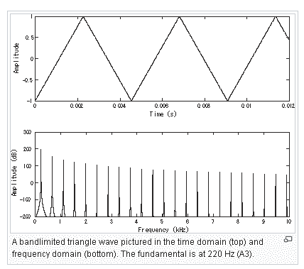

Next look at Fourier transform of a triangle wave
for some reason system refuses to show the wikipedia link ipasted it in four times.
Look for wikipedia triangle wave
https://en.wikipedia.org/wiki/Triangle_wave
Fundamental plus odd harmonics...Much easier approach using Fourier
Integration can be thought of as low pass filtering. It attenuates not removes higher harmonics.
So integrating once attenuates harmonics, integrating again attenuates them more. As you cascade stages of integration and attenuate the harmonics you approach just the fundamental which would be a pure sine wave.
Apparently some people are happy enough with two stages to claim it's a sine wave. Really it only resembles one.
Then there's the practical problem of keeping an integrator zeroed - it'll integrate its offset error and eventually saturate.
So if you build one use a low pass filters instead of integrators. Signal after each successive stage will more closely resemble a sinewave. After just a few your eye will be unable to detect the difference.
...So long as your top trace is positive, ie above the abscissa, integration proceeds upward so bottom trace should have positive slope for entire first, third, fifth half cycles of top trace, and negative slope for the even ones. You've reversed slopes in the wrong place.
Yes, yes, a thousand times: of course!

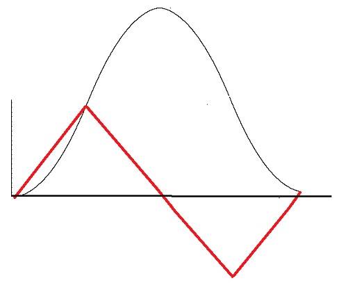

Is this more accurate:
Sorry it's a pretty rubbish drawing, but hopefully you get the picture.
Jim, to get you up to speed, we were previously discussing the result of the integration as being that of a parabola section.
But the result of the above picture doesn't look much like a parabola to me because it exponentially rises and falls sharply after the gradual rises and falls, which makes it look not quite smooth at the point where the triangular wave crosses the axis. Is this a fair representation?

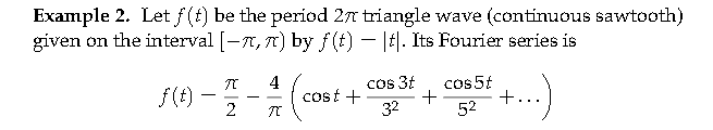

But you can integrate a triangle wave's Fourier series term by term
https://ocw.mit.edu/courses/mathematics/18-03sc-differential-equations-fall-2011/unit-iii-fourier-series-and-laplace-transform/operations-on-fourier-series/MIT18_03SCF11_s22_4text.pdf
Integrate that twice !
I'll wager the denominators get bigger, representing suppressed harmonics . If so intuition is confirmed.
here i cut and pasted together four y = x2 segments
used Paint to snip, flip and connect them
just to see how much y=x2 looks like a ¼ cycle of a sinewave ...
then i drew a triangle underneath just to relate it to what you're doing in this thread. .
Not bad. eh ? You could peddle that as a sinewave but it's not.
I wonder what another integration would do? y = x3 ?
Got a graphing program ? Plot all 3 over first quadrant and see how close they come.

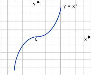

In my younger days i'd have done a longhand least-squares fit...old jim
I need to get MATLAB again, maybe there are free graphing programmes on the net. Because I'm not quite sure how your #14 Example 2. is a sawtooth wave, so I'll need to graph it to believe it (and the harmonics). I get that it's f(t) = t for the region -π to π, but I don't see how this is repeating.
Okay, so the drawing I made in #13 was not quite good enough.
You did an excellent job of cutting and pasting the x2's. It does look much more like a sine wave than I thought.
Honestly, I forgot about the denominators, that's how rusty my basic maths is, but yes, the denominators would grow with successive integrations.

Quadratics describe conic sections
https://en.wikipedia.org/wiki/Conic_section

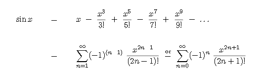

Conic sections are curved as is sine but i do not believe any simple quadratic describes a sine.
If it did the Taylor series for sine would be much simpler
http://people.math.sc.edu/girardi/m142/handouts/10sTaylorPolySeries.pdf
that doesn't look like the formula for a parabola.
I graphically pieced together segments of y=X2 which is curved and it indeed resembles a sine wave but is not one.

Yes I think you're right, that 'x' being squared as well as the 'y', makes all the difference in distinguishing a circle from a quadratic [parabola]. I suppose what I was remiss in was that any wave can be expressed as a series of sine components, but only a circle or sine wave can exist as only a sine wave. So the fact that a conical section wave has a sine component is irrelevant and insignificant compared to any other wave.
