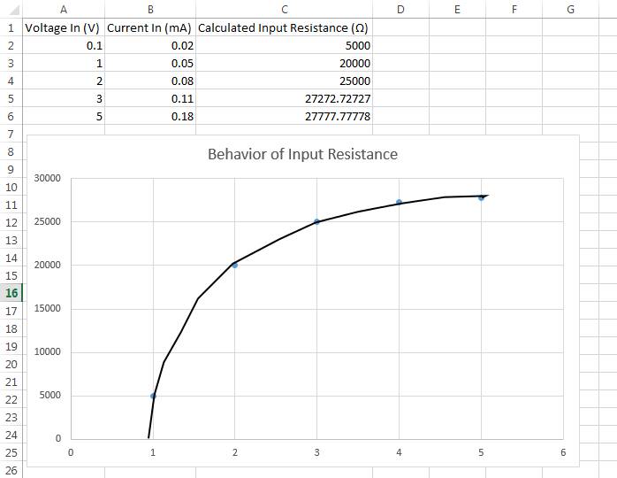

Sorry didn't mean to be secretive, lol. Here's a pic of the data and the graph I constructed from it (I just uploaded it here as a jog)

Again, I'll post the pic of my results, which has the resistance graph on it.

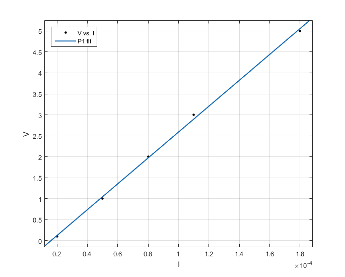

Here's a plot of your data with a polynomial degree 1 fit:
Doesn't look that bad. Fit gives an effective resistance of 30.85 kohm.
I'd take a guess that your measurements are a bit inaccurate down at those microamp levels. Have a look at the datasheet for your equipment for its accuracy at whatever range setting you're using.
Alternatively, lower the values of your resistors.

Yes, that is the plot I got as well ... and I do understand that we get resistance from the slope. I guess what I'm failing to grasp is why the Input Resistance varies, while the real resistance remains constant. My professor could not really explain it to me, he studied mechanical, not electrical lol. Quite simply, here is my confusion. Take the first data point, 0.1 volts, 0.02 milliamps. Then according to V=IR, the resistance should be 5000 ohms. But obviously the resistance was 31 kohms, so ... what is the concept I'm failing to comprehend?
The equipment you're using to measure this isn't perfect. Typically, the lower the value of something you're measuring, the more inaccurate your equipment gets. That's only 20 microamps!
Try redoing your experiment with lower values of resistors. Aim for an effective resistance of a couple hundred ohm or something like it. Make sure you don't go too low and fry your resistors, although this is a rite of passage that you'll inevitably go through at some point.

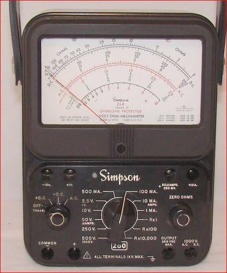

That's a pet peeve of mine. Beginners should start out with simple analog instruments.
This will measure 20 microamps with ease. With no ambiguity as to what range it's on.

i like to plot my raw data.
Observe that your plot is volts / amps with a very small denominator.
With such a small denominator a teeny error there exaggerates error in the result. Arithmetic just behaves that way.
Let's use hindsight, which is always 20/20
Looks like your resistor turned out to be somewhere around 27k ohms, a standard 5% value.
With 0.1 volts applied to 27kΩ you ought to get 3.7 microamps .
You wrote down 20 microamps. Probably the 2 is least significant digit on your voltmeter so shouldn't be believed. Consider writing instead "Too small to measure".
With 1 volt applied you ought to get about 37 microamps .
You wrote down 50 microamps. Least significant digit on ANY meter is ±1 count, so on your plot instead of a dot, how about drawing a vertical bar from 40 to 60 microamps and labelling it "limit of resolution". Observe that 37 rounds to 40, which is how your meter would report 37 were it a dead-accurate meter.
With 2 volts applied you ought to get 74.1 microamps and you wrote down 80.
Again your meter's resolution is ± 10 microamps so a vertical bar from 70 to 90 would represent what you can measure.
Observe as your measured variable becomes larger compared to your meter's resolution your error band becomes a smaller fraction of what you're measuring.
That's why i like analog meters better than digital for beginners. That the needle is so near zero makes it obvious to the eye you're at the limit of measurability.
We had a saying in my shop: " Twice as many digits makes your errors twice as accurate.".
Form the habit of drawing error bars around any measured data point.
Try it with your experiment - plot your measured currents on a linear scale and draw a best straight line through all the error bars,
see if its slope comes any closer.to the marking on your resistor.
27K is likely marked red-purple-orange, silver stripe = ±10%, gold = ±5%
Beware of small denominators. And overly smart voltmeters.
old jim
I'm in agreement with Jim. Other benefits (often, with mixed blessings) ...
  • It forces one to think twice about what scale the meter is dialed to, and which jacks the probe leads are plugged into before connecting the meter to a live circuit. Attempting a 480V measurement on the "R X1" range tends to make the leads disappear into a brilliant plasma cloud, and scares the bejeezus out of anyone within earshot.
  • You'll discover the principle of parallax error by learning how to properly read an analog meter, and by extension, will be able to accurately read pressures gauges, and other pointer-type instrumentation.
  • Although digital meters have many advantages, certain measurements are best done with an analog VOM, for instance, "bumping" the shunt and series fields in a compound DC motor to determine their polarity in relation to one another. Do this with an autoranging digital and all you'll see is a brief jumble of numbers, but an analog meter movement clearly reveals the direction of the inductive kick.
  • All voltmeters load the circuit they are measuring - think of the meter as a resistor in parallel with whatever the leads are connected to. Digital meters are high impedance (check your meter specs, but for a typical Fluke, 10 megohms springs to mind). The best that high-end analog meters such as Jim's Simpson 260 or equally venerated Triplett 630 can do is 20,000 ohms per volt (and the cheapest meters could be as bad as 1,000 ohms/volt). A 20KΩ/V meter on the 1 volt range "looks" like a 20KΩ resistor connected into the circuit.
  • #31
It is possible that there are no analogue meters available in the OP's lab. Shelf space can be tight in prep rooms and non-specialists can easily turf stuff out which has a value they just couldn't conceive.
