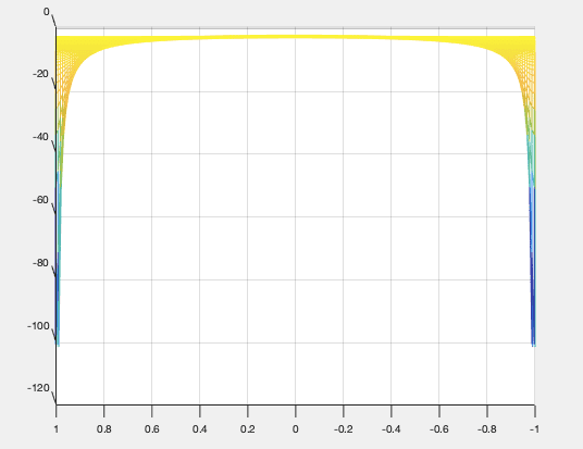

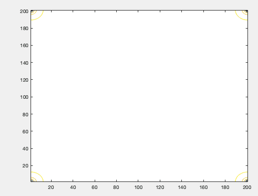

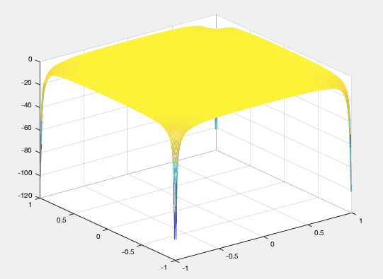

Imagine to be in 2 dimensions and you have to find the potential generated by 4 point-charges of equal charge located at the four corners of a square.
To do that I think we simply add all the contributions of each single charge:
$$V_i(x, y) = - \frac k {| \mathbf r - \mathbf r_i|}$$
$$ V(x, y) = \sum_i^4 V_i(x,y)$$
where ##\mathbf r_i## is the location of each charge. In particular if I choose the origin of the cartesian coordinates at the center of the square I get (the side of the square was set equal to 2):
##\mathbf r_1 = (-1, -1)##
##\mathbf r_2 = (-1, +1)##
##\mathbf r_3 = (+1, +1)##
##\mathbf r_4 = (+1, -1)##
Now. If I plotted it correctly I get something like this:
243082
243083
243084
Which clearly has a maximum.

Sorry, I corrected the graphs. It looks flatter but numerically I'm still able to find a maximum value at the origin.

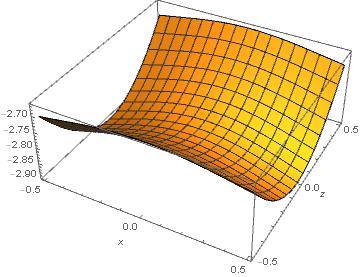

You are looking in only 2D for a function which is in 3D. If you plot the solution in the z direction you will see that the origin is not in fact a maximum, it is a saddle point. It is a maximum along lines parallel to x or y, but a minimum along lines parallel to z, thus it is a saddle point. The maxima and minima do indeed occur on the boundaries.
Here is a plot in x and z, where I plotted from -0.5 to +0.5 on each axis instead of -1 to +1 so that the shape is more visible. The same trend holds further out but it is harder to see.

I see. Thank you. But this leads me to think that I can't write a Laplace equation in 2 dimension for the the above problem, right ?
Kudos @Dale !
o:) to forget ##{\partial^2 V\over\partial z^2} < 0 ##
Well, you certainly can write a Laplace equation in 2 dimensions, but I don't know how you would write Maxwell's equations in 2 spatial dimensions. Also, if you did write Maxwell's equations in 2 dimensions I don't know what the potential would look like and I don't know if it would still satisfy Laplace's equation (I suspect not). So the 2-D issue isn't actually with Laplace's equation but Maxwell's.
Likes dRic2
Yes, I meant Laplace equation as a consequence of 1st maxwell equation (gauss equation) written for the potential instead.
