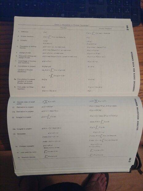

Most Fourier Transform problems in homework (as opposed to real data) are based on recognizing standard forms (i.e. transform pairs of common functions) plus some properties of the transform, like the shifting and scaling properties. Does the general form of this transform look like something you've seen before?
OK, the printed book is old school (like me, LOL), but your life will be easier if you study this stuff ASAP. This is really what the question is about.
