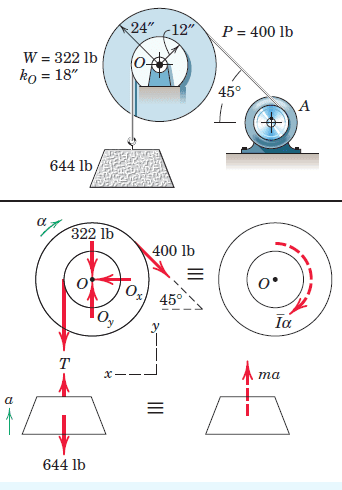

Because I always thought that Gear D can still turn in the opposite direction than the load. For example, please see the screenshot below of Meriam's book.
The load is the concrete block and the drum tries to lift it. Here, the load is counter-clockwise, but the drum can turn clockwise. Let me know if I interpreted it wrongly.

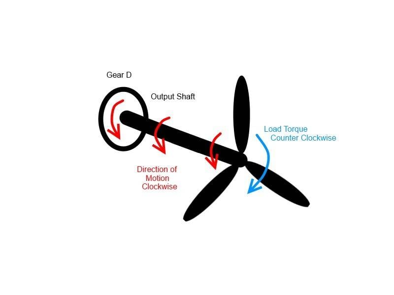

Here is a diagram of Gear D driving the output shaft and a load. In this case the load is an aircraft propeller but could be anything else like a disc brake or generator.
I guess I misunderstood what you meant by "the load".
Yes, sorry about that. What do you mean by the load in your diagram then? Because in my understanding, the load in your diagram is any torque that opposes the motion of gear D, for example the propeller weight and wind friction (may be, I'm not quite familiar with aerodynamics). What I know for sure is the load on the picture I showed previously is the concrete block. What do you think? Thanks a lot for the nice diagram, by the way. :)
I would call the propeller the load but I suppose it's the load torque that matters.
