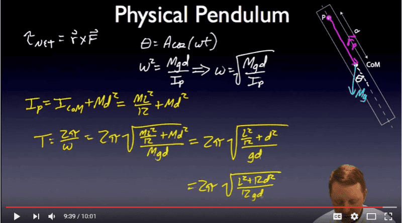

I've seen it written [tex]\omega^2[/tex] in several places though, what makes you say that? Here's a screen clipping of a video from (credit to Dan Fullerton on Youtube)
I don't know where [tex]\theta=A cos(\omega t)[/tex] comes from either, but heard there are two uses for [tex]\omega[/tex] in rotional motion?
View attachment 203485I don't know where [tex]\theta=A cos(\omega t)[/tex] comes from either, but heard there are two uses for [tex]\omega[/tex] in rotional motion?
Is ##\omega^2=\sqrt{\dfrac{mgb}{I}}## correct ?
Sorry I don't know much.
it is ##\omega=\sqrt{\dfrac{mgb}{I}}##, that's because a general ##\alpha(t)=-\omega^2*x(t)##
