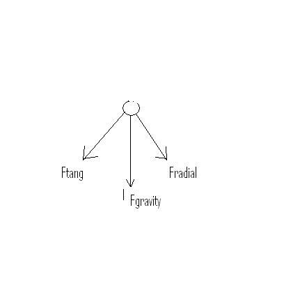

Below is the image of the question I am having trouble with.
B) and C) I need help with!
Can anyone point me in the right direction? B and C are my trouble questions.
I don't know how to prove that the small object will slide back and forth
inside the track in simple harmonic motion with period
T = 2π sqrt (r/g)

I am not really sure how the f=ma part
Attached is my FBD

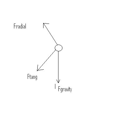

Pretty good! The F radial should go the opposite way, where it is canceled out by the force of the track on the mass. Now you need to get the angle theta on your diagram and get an expression for Ftang in terms of the angle, mass and g. Finally, say that force equals ma.
So this is correct (image)
So, Fradial cancels out - Ok!
Dont quite understand what you said here :( "Now you need to get the angle theta on your diagram and get an expression for Ftang in terms of the angle, mass and g. Finally, say that force equals ma."
Extend your diagram to include the diagram given in the question with the θ on it.
Figure out where θ goes on your part. Is it between Ftang and Fgravity or what?
You must find the angle between Ftang and Fgravity - it might be θ or something like 90 - θ. Then make a right triangle with hypotenuse Fgravity, side Ftang and one more side you add at 90 degrees to Ftang. Use trigonometry to express the relation between Ftang and Fgravity.
