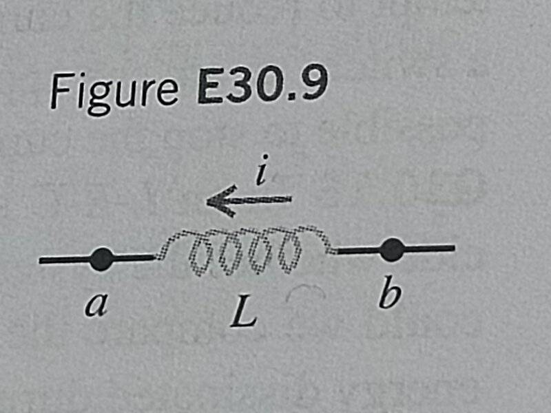

The inductor in the figure has inductance 0.260 H and carries a current in the direction shown that is decreasing at a uniform rate, ##\displaystyle\frac{di}{dt}## = -0.0180 A/s.
(a) Find the self-induced emf.
(b) Which end of the inductor, a or b, is at a higher potential?
##\displaystyle\mathcal E=-L\frac{di}{dt}##
(a) ##\displaystyle\mathcal E=-L\frac{di}{dt}## = -0.260 x -0.0180 = 0.00468 V = 4.68 mV
(b) Current always flows from higher potential to lower potential. So, b is at a higher potential.
My textbook says that my answer for part (a) is correct but part (b) is wrong. Please help!

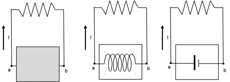

at the OP: Imagine that the inductor acts as a voltage source. Which side (a) or (b) should be positive (and the other negative) in order to tend to produce a current in the circuit that augments the decreasing current?
Likes Charles Link
Delta2 said:
@Meow12
Are you saying that the inductor acts like a battery? Inside a battery, current flows from lower potential to higher potential. (Is this correct?) So, a is at a higher potential.

We can consider the inductor to be a voltage source with the inductor on the left in the circuit, kind of like a battery, with other resistors on the right with current running clockwise.
We then write ##\mathcal{E}=-L \frac{di}{dt}=iR ##.
We see with ## \frac{di}{dt} ## negative that the voltage will be positive that gets delivered to the resistors.
That tells us the upper end of the inductor is positive.
We can alternatively treat the inductor as a component like a resistor or capacitor, and have a different voltage source ## V ## in the circuit, and then we write ## V=+L \frac{di}{dt}+iR ##, and we see there will be a voltage drop across the inductor when ## \frac{di}{dt} ## is positive, so that when ##\frac{di}{dt} ## is negative, the more clockwise end of the inductor will be at the higher voltage.

No. Compare with the expression ##F=-kx## expressing the force exerted by a spring that is displaced from its stretched position by an amount ##x##. The negative sign means that when the displacement is positive (to the right) the force is negative (to the left) and when displacement is negative (to the left) the force is positive (to the right). One concludes that what is on the left-hand side (force) always opposes what is on the right-hand side (displacement).
Here, we have ##\frac{di}{dt}## on the right hand side not ##i##. One concludes that the induced emf ##\mathcal{E}## always opposes the change in current ##\frac{di}{dt}##. How does it do that? By having a polarity such that it would generate an induced current ##i_{ind}## that would oppose the change. That means and induced current that would flow from b to a.
The question now is which point must be at higher potential so that we get that induced current. Look at the picture below, left. It shows a closed circuit with current flowing from b to a. What generates this current is hidden. However, it is clear that point a is at higher potential than b otherwise the current in the resistor would not be flowing left to right. If you are allowed to see what is hidden, it might be the inductor that we have here (middle picture) or a battery (right picture.)

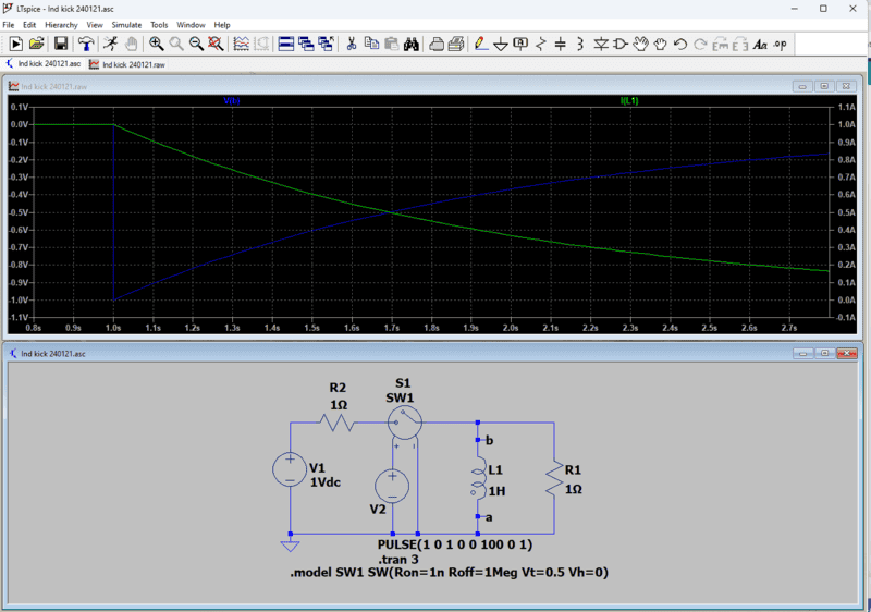

Y'all need to build a flyback or boost SMPS, or maybe fiddle with the ignition coil on a 1965 Mustang. This polarity question will then become quite obvious. The EEs that made the power supply for whatever device you using right now don't argue so much about arcane physical descriptions. This may be why we had to take a lab course in college.

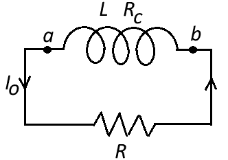

Joline and Tim are considering a circuit that consists of an inductor of inductance ##L## and a load resistor of resistance ##R##. Unlike an ideal inductor, the coils of the inductor in this circuit have a non-negligible total resistance ##R_C##. At time ##t = 0##, there is a current ##I_0## in the direction shown and the current is decreasing. They want to work out the current as a function of time.
The two are arguing about which point ##a## or ##b## is “at the higher potential”. Joline claims ##a## must be at the higher potential to drive current through the load resistor ##R## in the given direction. Tim disagrees, saying that ##b## must be at the higher potential to push current through the resistance ##R_c## of the inductor in the given direction.
They decide to visit their professor to find out who is right. Professor L. smiles and says, “You two have a conundrum because you both believe that ’potential at a point of this circuit' has meaning. It doesn’t. You don’t need to consider potential at all. Electric field is what pushes the charge carriers. Just use Faraday’s law!” $$\oint \mathbf{E}\cdot \mathbf{ds} = -\frac{d \Phi}{dt}.$$
Joline and Tim agree to try this. For the closed path of the integral of the electric field, they choose a path that goes once around the circuit in the direction of the current and the path stays within the conducting material of the circuit. (So, the path through the inductor follows the corkscrew windings of the inductor.) They see that the rate of change of magnetic flux through this path of integration can be expressed as ##\large \frac{d \Phi}{dt} = L\frac{dI}{dt}##. Assuming that the hookup wire connecting the inductor to the load resistor has negligible resistance, they write Faraday’s law as $$\oint \mathbf{E} \cdot \mathbf{dl} = \left(\int \mathbf{E}\cdot \mathbf{ds}\right)_{\rm through \, load}+\left(\int \mathbf{E}\cdot \mathbf{ds}\right)_{\rm through \, inductor} = -L\frac{dI}{dt}.$$ From Ohm’s law, the integrals through the load and the inductor can be written as ##IR## and ##IR_C##, respectively. Making these substitutions and rearranging, Joline and Tim agree that the differential equation that determines the current as a function of time is $$\frac {dI}{dt} = -\frac{R + R_C}{L} I.$$ From this they derive easily the current as a function of time.
