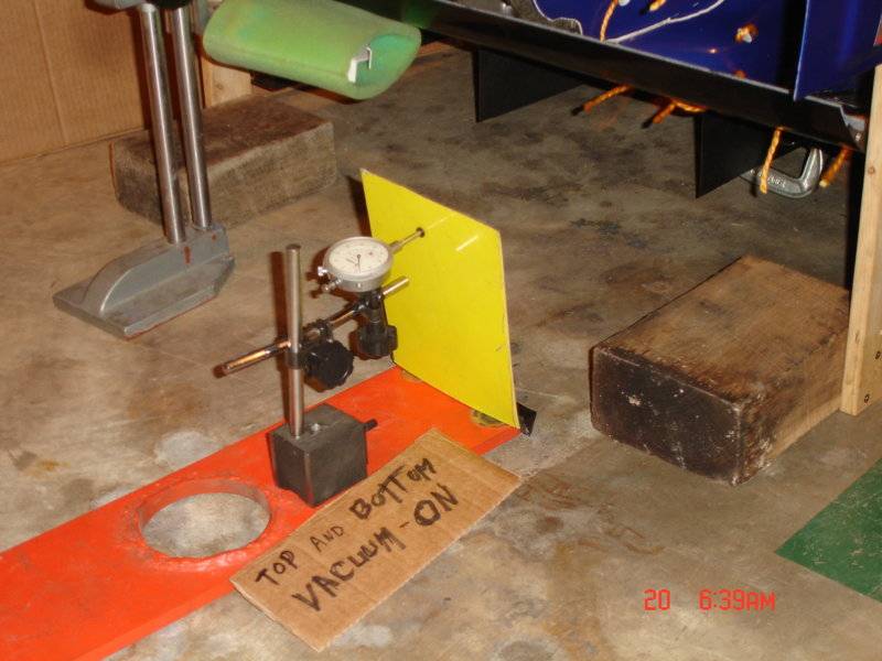

We rigged up a shop vacuum cleaners to blow air over the top of the rear diffuser and under it. A diffuser is an air foil device covering the bottom side of the race car. It is curved at the rear so the air exiting under the car would take an upward path and exit pointed at an upward angle. This created down force. Bernoulli effect. By taping tufts of yarn at various points on the underside and top side of the diffuser and lower wind element we could see the flow without the diffuser pump the after the diffuser pump and finally the flow at best attack angle of the little mini wing. We made a height stand and taped yarn tufts every 3 inches so we could see the flow right off the lower rear wing and a foot from the rear wing. We did the same at exit points on the car.We needed to back up the manometer readings with some other measurable way to get a solid repeatable number. A metal plate and dial indicator on the magnetic stand would be the gage and a thin piece of aluminum sheet with a duct tape hinge would prove quite repeatable when placed in the wind stream. As we dialed in the proper attack angle the reading dropped on the under diffuser flow and the stream blended in with the air coming off the top of the diffuser.

So the photos show the good flow as noted by the number of tufts streaming on the height stand furthest from the wing. Note the number of tufts not floating in air. Only two are really flying straight out.
Then note the 8 tufts flying in the air stream on the final best flow pic. We got the tow streams blending and combining to reduce drag and increase down force.
Bottom line is that you can do a lot with what you got on hand ifin you think about it.
