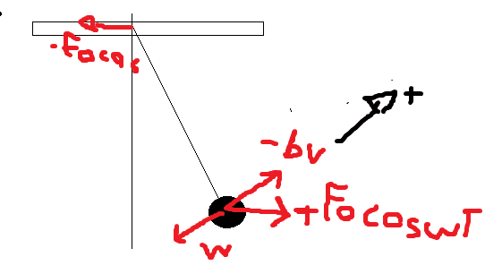

The problem is how to construct the right diagram of forces actually
Unfortunately, the Fo*cos acting on the ball will not carry the g/l of the solution
-mg*sin(´p) + (-bv) + (Fo*cos(wt)*cos(p)) = mx''
Fo*cos(wt) = mx'' + mg*x/l + bv

You do not care what force is applied at the point of suspension. You only care where that point is at time t, and how that affects the angle of the pendulum.
