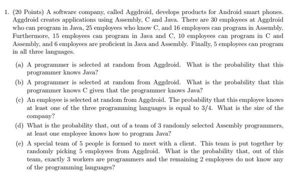

This looks like a very simple question but I just can't seem to wrap my brain around it:
Baye's theorem, etc.
For part (a)
To calculate this probability I need to know the sample space of the programmers right? This is the main thing I'm having trouble with.
I was thinking I just need to add up how many know Java, C, and Assembly (30 + 25 + 16) for the sample space and divide that by the number of people that know Java.
The amount of people that know Java would be 30 (Java) + 15 (Java and C) + 6 (Java and Assembly) + 5 (Java and C and Assembly).
So would the probability be 56/107? I'm really not sure about it though because I feel like I'm double-counting somewhere

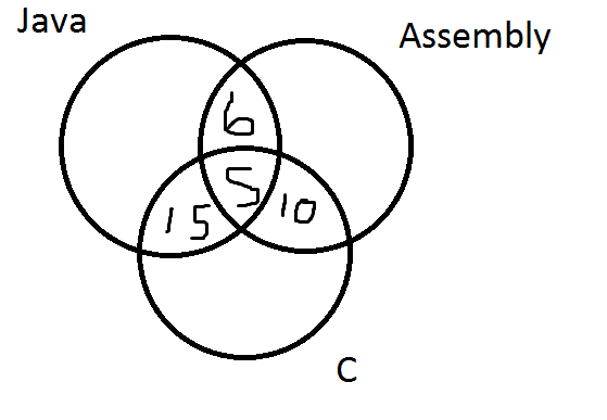

Hi, haruspex, thanks for replying.
Would a venn diagram look like this?:
because I don't know the number of programmers that only know exclusively one language?
Right idea but wrong numbers. According to your diagram, how many can program Java and C (whether or not they can handle Assembler)? How does that compare with what you are told?

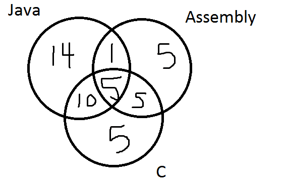

Ohhh I think I see now. According to my diagram, 20 can handle Java and C. So I essentially need to build the diagram from the inside out starting with the very middle
Is this correct?:
Also to find the total amount of programmers, would I do:
J + C - J∩C + A - C∩A - J∩A + J∩C∩A
If I add J and C I'd be double counting some of J so I subtract the intersection, and do the same for the other elements. And at the end I'd need to add the intersection of all 3 elements since it kept getting subtracted out.
So there would be 45.
Then the probability that a programmer knows Java is 30/45, or 2/3.
