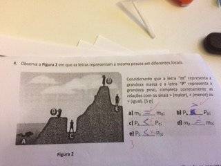

Thanks for the answers. I should state that my son is only 12, so I'm guessing that the premises are simple, such as the density of the Earth is considered to be constant. I simplified the question a little just to get the idea I needed, but now I think the teacher himself got it wrong. I'm uploading a photo of the question:
It's not in English, so m = mass and P = weight (peso). If what you say is correct, then ##P_A < P_B## I guess.

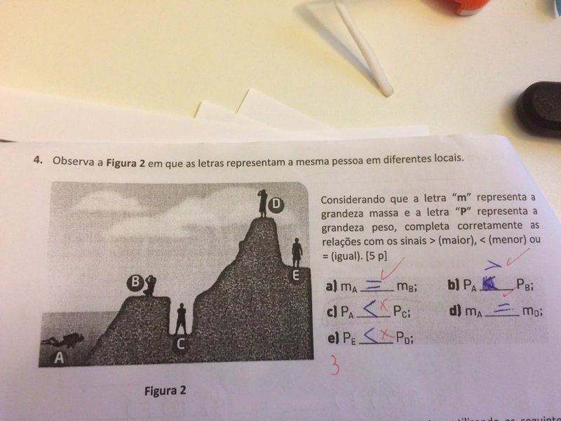

The photo is such a poor quality that it is not possible to make out some of the letters. Can you post a better quality photo?
At 12 years old, I'd expect the question only to concern the distance from the centre of the Earth, so only height matters. The question seems to be designed to test the ability to understand the difference between the physical concepts of mass and weight.
If that's the case, then it's always lower=greater weight. Being immersed in water is a red herring.
I seriously doubt a class at this stage would have worked through the implications of varying mass, uniform density or not, especially since that'd require introducing the other consequence of shell theorem - telling kids that they can treat all of Earth's mass as if it were concentrated in the centre can usually fly without any actual explaining, but disregarding mass in the shell is a taller order.
Likes kuruman and TomHart
Thanks. I think you're probably right. The part about being immersed in water threw me too, when going through the test with him. I knew that the water exerts a buoyant force which counteracts the diver's weight, but I wasn't sure whether his "weight" was considered to be the balance of vertical forces or independent of other forces acting on him. The point made earlier about someone not being weightless sitting in a chair makes it clear, though.

Yes, but your original statement did not make it clear that you were comparing sea level with deeper. Indeed, the question has nothing deeper; in the context of the question there is only sea level (beach or scuba) compared with up a mountain (which, while still on Earth's surface, is above sea level).

Can we agree on "closer to sea level implies greater weight"? Though of course it is a bit more complicated than that.

I would agree with that. It's still not clear to me, though, what "below sea level" might imply in the context of this question for 12-year olds.
