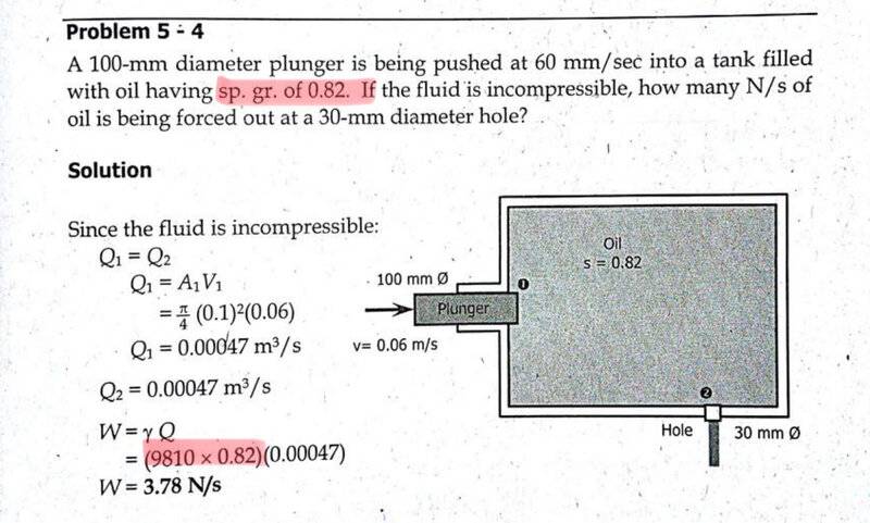

A 100 mm diameter plunger is being pushed at 60 mm/sec into a tank filled with oil having sp.gr. of 0.82. If the fluid is incompressible, how many N/s of oil is being forced out a 30-mm diameter hole?
weight flow rate = unit weight x Q
Q1 = Q2
i’m studying my textbook in hydraulics and i’d like to know the reason why specific gravity is used in one of the problems. it’s a pretty simple problem and i understood it mostly except why specific gravity is multiplied to 9810 (the unit weight of water). if the SG is given in the problem, is it always multiplied to the unit weight?

i do know that specific gravity is the ratio of density of fluid over density of water. what i am confused tho is why it is multiplied to the unit weight 9810 when it isn’t stated in the formula? i just want that part cleared up so i won’t be confused on future problems anymore

You are expected to be able to adapt a formula if necessary. Don’t expect a different formula for every possible slightly different variation of a problem.
The question asks for the flow-rate in N/s, so you know that you are being asked to calculate the weight of oil coming out per second. (As already noted, this is a rather unusual way to express flow-rate.)
You should be given the nominal value for the density of water (1000kg/m³) and for the acceleration due to gravity (9.81m/s² = 9.81 N/kg). You are expected to sort out for yourself that:
a) the density of water can be expressed as 1000*9.81 = 9810 N/m³
b) the density of oil can be expressed as 9810 x 0.82 N/m³
c) multiplying ##Q_2## (outgoing flow rate in m³/s) by 9810 x 0.82 N/m³ will give you the flow- rate in N/s as required.
… where Q is the volume per unit time, and unit weight means weight per unit volume.
(volume/time)x(weight/volume)=(weight/time).
drdyke said:
…here the process became weight flow rate = unit weight (SG) x Q
SG is defined as the mass of a given volume of the substance divided by the mass of an equal volume of water.
weight of volume V of substance = (mass of volume V of substance) x g
= (mass of volume V of water) x SG x g = (weight of volume V of water) x SG
Dividing through by the volume:
weight per unit volume V of substance = (weight per unit volume V of water) x SG
i.e.
unit weight of substance = (unit weight of water) x SG
