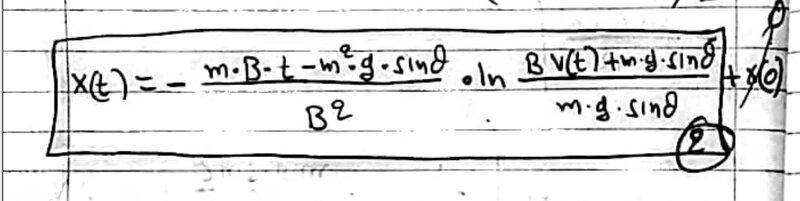

I actually figured it out but I believe I still made a mistake somewhere (Probably math-related) because the time that I got, does not seem to be in seconds...
I attached a pdf file since the solution is quite big and I can't write it in latex.
I figured out the following time @ v(t) = 0 (ball stops moving upwards):
##t = - \frac{m}{B} \cdot ln[\frac{m \cdot g \cdot sin(θ)}{m \cdot g \cdot sin(θ)+B \cdot V_{0}}]##
I'm not sure if this is in seconds. I don't even know what units B has.
The enumerator ##mg## is in Newtons. The denominator is also in Newtons ##B\cdot V_{0}## I'm guessing this by the drag formula. So B is in ##\frac{kg}{s}##? So ##\frac{kg}{s} \cdot \frac{m}{s} = \frac{kg \cdot m}{s^{2}} = Newtons##?
This means ##ln[\frac{m \cdot g \cdot sin(θ)}{m \cdot g \cdot sin(θ)+B \cdot V_{0}}]## is just a plain number since ##\frac{N}{N}=1## and it actually must result in a negative number.
So ##\frac{m}{B}## , ##\frac{kg}{\frac{kg}{s}}=s##
If B is indead ##\frac{kg}{s}##, this seems correct.

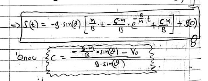

Wow, I think I'm getting it! So you basically create an association between distance and velocity. In other words, you express the distance as a function of velocity and once you figure that out you will just plug in 0 for velocity, yielding the answer of the exercise immediately. Is this correct?
The reason I didn't think like that it's because most of my experience in Physics comes from high school where we were always taking a 2-way step (first find the time and then use it to find something else) or something similar.
Yes, the idea is to find the velocity as a function of position and relate position and velocity at point A (where you know the velocity and the position) to an unknown position where the velocity is zero. It is sometimes called a first integral.

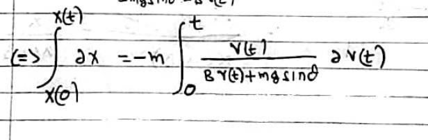

It is not correct. Think of the transformation this way ##\dfrac{dv(t)}{dt}\rightarrow v(x)\dfrac{dv(x)}{dx}.## Then you separate variables and you have an integral over variable ##v## on the left-hand side and another integral over variable ##x## on the right-hand side.
Likes babaliaris

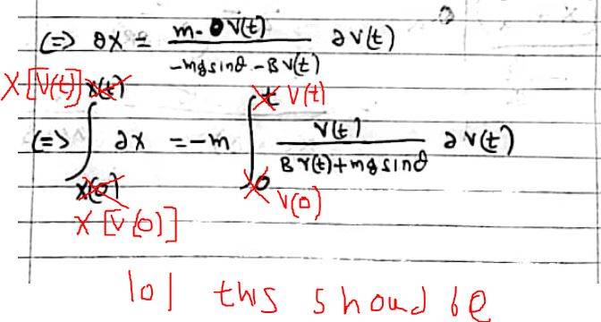

But this is exactly what I got. And solving this for x(t) I got the following:
It may be what you got but it is not correct because there should be no time variable ##t## in it. Start with
$$\frac{v~dv}{Bv+F}=-\frac{1}{m}dx.$$Now integrate both sides:
$$\int\frac{v~dv}{Bv+F}=-\int\frac{1}{m}dx.$$Remember that an integral is a summation. On the left-hand side we are adding pieces that look like ##\dfrac{v~dv}{Bv+F}## where ##v## is the instantaneous velocity at position ##x## and ##dv## is an increment of the velocity that takes us to the next instantaneous velocity. On the right-hand side we are adding pieces that look like ##-\dfrac{1}{m}dx## where ##x## is the instantaneous position when the velocity is ##v## and ##dx## is an increment of the position that takes us to the next instantaneous position. There is no variable ##t## anywhere.
All you have to do is set the limits of integration. In other words, at what pair of velocity and position should you start adding and at what pair of velocity and position should you stop adding? These pairs are the lower and upper limits of integration.
Likes babaliaris and nasu
LoL I found my mistake:
That's good. Now you have to do the integrals.
Likes babaliaris

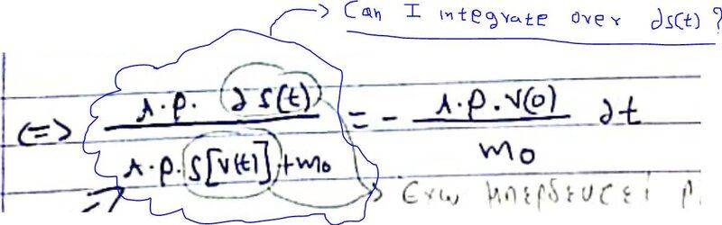

This is from a different exercise but it has the same idea (with the one of this post) in order to get s(t) from the s[v(t)] relation:
I'm not sure if I can integrate over ##ds(t)##. My professor indeed does it but he doesn't show the dependency of each variable so I don't know if s depends on t or v(t).
