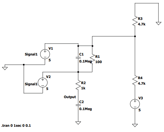

I need to understand the below hardware circuit
I am not sure about the type of the signals at signal1 and signal2, i have assumed DC signals initially. Then when i simulated in LT spice, the signal at Output is +5V. But if i assume the signals at signal1 and signal2 as Sine wave, then C1 and R1 will be like a filter circuit, am i correct? But what is the main purpose of the above circuit? Some information i decoded is signal1 and signal2 are coming from the connector, and they are Current transformer signals of the phase currents. Please help me to decode this.
If V1 and V2 are AC sources that can be different, it is not good to have them directly driving the capacitor C1 (which is an AC short). Is this just a practice circuit that you made up?
I am not sure if the signals Signal1 and signal2 are AC or DC, if AC signals are not correct, then they should be DC signals and if they are same,could you please tell me the purpose of the circuit if they are DC signals?
In the actual circuit V1 and V2 are not mentioned only for the simulation purpose i have added V1 and V2. The connection at output is going to the micro controller.

It would help if we could see the whole schematic and know what the intended purpose is. Looking only at some parts of a circuit may not may not be useful.
C1 and C2 have values of "0.1 Meg" farad ?
Are you sure those should not be something smaller, like maybe 0u1 farad ?

Beyond the capacitor value errors, you have drawn the circuit with 3 inputs and no outputs. How are we supposed to guess what transfer function you want to discuss?
Likes dlgoff
The output is below R2 which goes to micro controller.

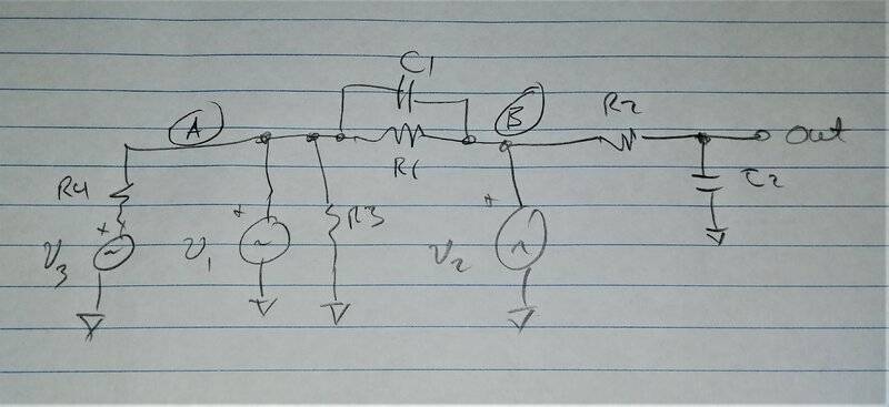

Well, the circuit still makes little sense to me. If V3=5V, that sets the bias voltage between R3 and R4 initially to 2.5V. But having V1 be a DC power supply then makes no sense, since that voltage is already set to 2.5V. But if V1 is an AC source, then it makes no sense to have V2 where it is, since it is an AC short via C1. So as drawn, I don't think V1 can be either AC or DC, and similarly V2 makes no sense where it is placed.
If there were no V2 source and V1 were an AC source, you could calculate (and simulate) the transfer function from V1 to the "Output" node. It looks at first glance to be a sort of a bandpass transfer function, with some modifications.
Again, it would be best to see the whole original circuit diagram, hopefullyl without the capacitor value errors shown on your LTSPICE rendition of the circuit.
Aside from the many practical issues raised, which I'll leave to others, this is just an electrical network problem. You can express each component with it's complex impedance and find what you want with the normal circuit analysis tools (KVL, KCL, Thevenin-Norton source transformations, etc.). If you just view this as a math problem, it doesn't matter what the voltage sources actually are; ##v_1(t)## is a perfectly adequate variable name. If you have numbers to put in, like ##R3=4.7K##, then you'll do that as the last step.
Are you familiar with complex impedance values?
My personal preference would be to redraw that schematic with inputs on one side and outputs on the other side. That can make the analysis quick using some obvious shortcuts. What can you see about the node voltages? Do you actually care about every detail, like the current through R4, for example?

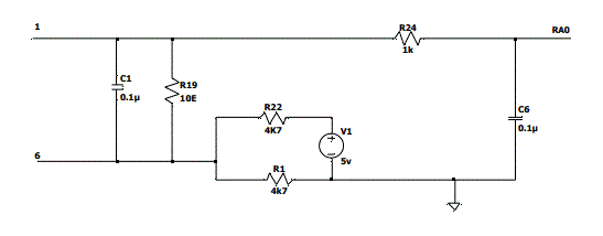

Please find the circuit copied in the path . RA0, RA1, RA2 go to the micro controller. Is the circuit correct? If it is wrong i will stop analyzing.
Where do the Current Transformers connect to that circuit? It's for a 3-phase AC Mains current measurement device?
Yes.

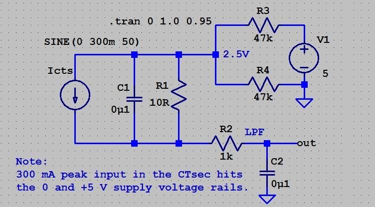

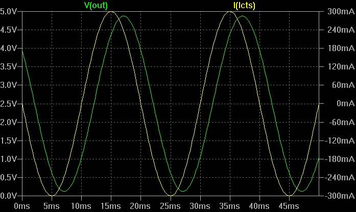

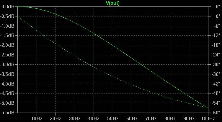

My take on the CT interface diagram in post #18 is as follows.
R1 with R22 divider produces DC bias = 2.5 volts, with R thevenin = 4k7 / 2 = 2k35
C1 = 0u1 farad; in parallel with; R19 = 10E = 10R = 10 ohm, (1/4 watt); is the burden for the CT. Shown as terminals 1 and 6.
R24 = 1k; in series with; C6 = 0u1; forms a low pass filter to the analog input port RA0.
Note that the Rth of 2k35 is in series with the 1k, so low pass has R = 3k35 with 0u1 F.
Software must discover the exact input voltage for zero current since 4k7 dividers are otherwise uncalibrated.
Likes PhysicsTest

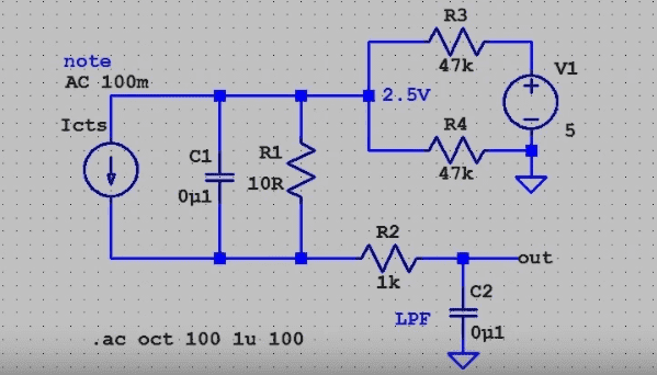

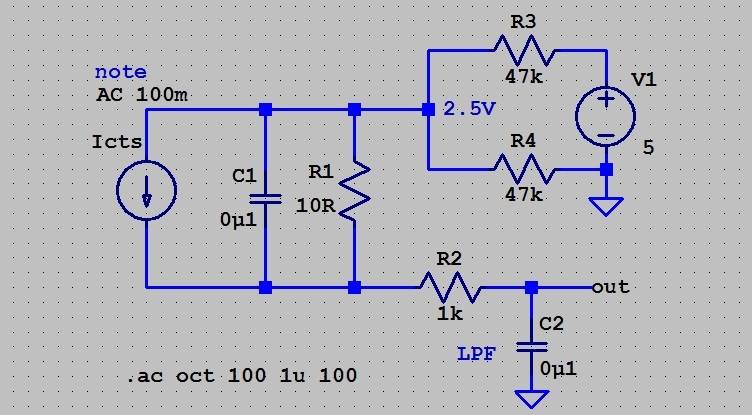

The voltage to the analog input when no current is flowing in the CT will be close to 2.5 V. The resistors in the voltage divider may be slightly different, so you need to find just what voltage represents zero current. Without the CTs being connected, read each analog input to identify zero for each channel.
Note that a CT will often have an internal resistor of maybe 470R, that is to protect the insulation from overvoltage arcs if you unplug it from the burden on the PCB. That unknown protection device may change the calibration scale slightly.
Avoid decimal points. "0.1μ" is better written in LTspice as "0u1". It may then be displayed as "0μ1" if that option is turned on.
Avoid the exponential "10E", use instead the more common "10R".
"10E" is actually a suppressed zero exponent, floating point "10E0" = "1E1" = 10.
Never put units on component values, or on voltage and current sources.
1F is not one farad, it is one femtofarad. 1A is not one amp, it is 1e-18 amp.

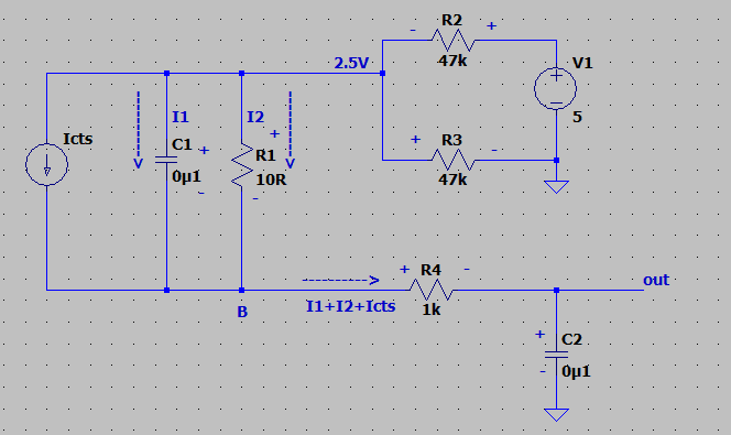

I am trying to solve the schematic manually using node equations
The current through C1 is i1, R1 it is i2, through R4 is i1+i2+icts.
##V_{C1} = V_{R2}##
##\frac{\int{i_1} dt} {C_1} = i_2 R1## -> eq1.1
##2.5 - i_2R_1 - (i1+i2+i_{cts})R4 = V_{out}## -> eq1.2
##i_{cts} + i_1 + i_2=0 ## -> eq 1.3
Are the equations correct to solve for ## V_{out} ##.

Thank you for all the help, i know i am confusing all, circuit analysis is always tough for me. I am doing another attempt
Loop1 : Consisting of elements C1 and R1
## \frac{-\int I_1dt} {C1} + I_2R1=0 ## -> eq1
Loop2: consisting of 2.5V, R1 and R4
##2.5 - I_2R_1-(I_1+I_2+I_{cts})R_4 = V_{out}## -> eq2
##I_{cts} = I_0\sin(\omega t)##
I need one more equation, Please help me if the equations are correct and where do i apply the next equation?
  • #34
Sorry, too busy to write a real reply. But that node labeled 2.5V is only 2.5V if there's no current being drawn through those 47K resistors. You can't leave R2 & R3 out, also C2 needs to be included. Those parts are in loops you haven't included yet.
But, good work on defining things, now we can all speak the same language.
##2.5 - I_2R_1-(I_1+I_2+I_{cts})R_4 - \frac{\int (I1+I2+I_{cts})dt} {C_2} = 0 ## -> eq2
##I_{cts} = I_0\sin(\omega t)## ->eq3
The current through ##R_2 = \frac{2.5} {4.7k} = 0.53mA ## ->eq4
Similarly current through ## R_3 = \frac{2.5}{4.7k} = 0.53mA ## ->eq5
## I_1 + I_2 = 1.06mA ## ->eq6
Can i use the above equations to solve for Vout?

PhysicsTest said:
But it will always be 2.5V since the resistors are equal and by voltage divider rule, it shall be 2.5V.
The Thevenin resistance, Rth, of the 2.5 volt reference is 4k7 / 2 = 2k35 . That Rth is in series with the 1k0 of the LPF, making 3k35 total. If you ignore Rth, the transfer function will be incorrect.
You must close the circuit from ground of the LPF, to the ground of the bias network.
I still do not know what you are doing, nor why.
The main reason why i am trying to do is, to derive an expression for Icts as a function of resistors and Vout. Develop firmware to use this formula calculate and display the Icts (additionally convert this into phase current) on lcd. Is my approach correct?

Hi @PhysicsTest...
Now that you have defined the components and have an easy-to-read schematic, etc, let's try breaking the circuit down to the DC component and then add in the AC component.
We will be making a few assumption along the way, and later add in corrections to cover the assumptions.
For the first part let's try to find the DC voltage at the A/D converter input. We can ignore the CT and the capacitors for this, just assume they do not exist or are open circuits.
What IS needed is the input impedance of the A/D converter. We may decide later that this can be ignored if it is much higher that the circuit resistance values, but we don't know that yet!
Next would be to draw a schematic with the Voltage Source, the Resistors, and the Input Impedance of the A/D converter. From that you can calculate the 'Zero' reading at A/D input.
Now you get to make a decision. Is the calculated DC voltage at the A/D input enough different from the 2.5V 'Ideal' voltage to really matter? If you want to end up with the Complete design equations, this step is complete and you can ignore the next paragraph
For instance, if the voltage difference between using the A/D input, and assuming it is an open circuit is less than the A/D resolution, then consider the A/D as an open circuit and use the 2.5V divider voltage. (In the real world, there may be a variable resistor in the R2 - R3 divider network to trim the Zero voltage.)
Now consider the situation with the CT connected. The CT will have some internal resistance which is in parallel with the 10 Ohm resistor. The equivalent parallel resistance can be substituted in the equation derived above for the 'Zero' DC input to the A/D converter...
Or, again, you may want to substitute the equation for the parallel resistances into the DC equation derived above.
That completes the basic DC bias point calculation. If this was a design for producing many of these circuits, things like the resistors tolerances and maybe their resistance variation with temperature would also be accounted for.
Sorry for hijacking this thread, after you get the DC bias point completed, I will bow out and let the others here carry on their fine support.
Cheers,
Tom
p.s. Remember details count, and the more of them you supply the easier it is for everyone. (except maybe you when you have to type so much :wink:)
