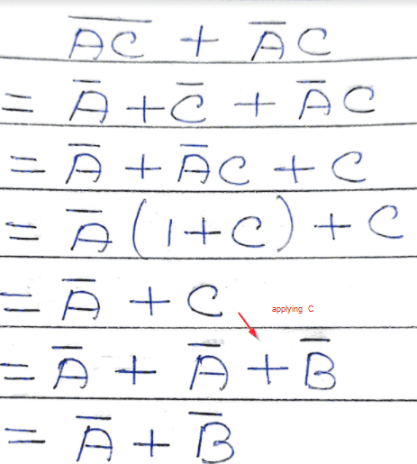

I am trying to solve this problem
I have solved this myself in two different ways, but i am getting different results.
Solution # 1
Solution # 2
Now to find :
Please see output is different in solution#1 and solution#2.
Which solution is correct ? Is there anything I am missing.
recheck your work there is a simple error.

Could you please be specific ? where is the error ? I am unable to find it.
line 3 in the last box.
Often a good way to check when things don't seem right is to just redo the problem, for small problems, anyway.
You might also notice that both of the original equations can be simplified (they have the same form) before you do any substitutions. That isn't necessary, just another approach.
If you've learned about Karnaugh Maps this would be a good place to use them too. Again, not necessary, just another option.
Thanks. I spotted error. This helped a lot.
