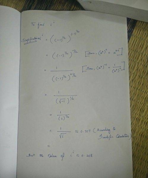

Where is my simplification wrong?

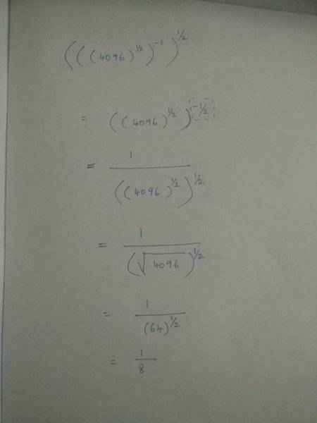

##(((64)^{1/2})^{-4})^ {1/2} = (64^{1/2})^{-4/2} = 1/64##
I wrote it on this basis.
When you replaced ##i^i## with ##{((-1)^{(1/2)})}^{((-1)^{(1/2)})}##, you forgot the parentheses around the "i" in the exponent.
Exponentiation is not associative. ##(a^b)^c## is not, in general, equal to ##a^{(b^c)}##.
Likes Leo Authersh

And that is my question. Why the general formula becomes irrelevant when 4096 is replaced with -1.

You misunderstand. It's not the -1 that's the problem. It's the parentheses.
Edit:
##{(a^b)}^c## is equal to ##a^{(bc)}##
But obviously,
##a^{(b^c)}## is not equal to ##a^{(bc)}## [unless ##b^c## just happens to equal ##b \times c## or a just happens to be equal to 1]

Start with $$i^i$$
Replace each i with ##({(-1)}^{(1/2)})##. The parentheses are there to ensure proper evaluation order. $${({(-1)}^{(1/2)})}^{({(-1)}^{(1/2)})}$$
Now look at that expression and try to find something with the form of ##{(a^b)}^c##. You originally thought you had something with:
a=##{({(-1)}^{(1/2)})}##
b=##(-1)##
c=##(1/2)##
But the parentheses mess that up. It's not of the right form.
Likes Leo Authersh
