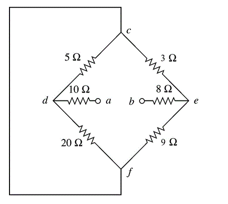

Find resistance across a and b terminal
Not sure what I can do to proceed on here: Should I be using the Delta to Y transformation? Wouldn't be able to simplify using simple series and parallel circuits, and hence am looking for any clues I might need to solve this problem.
PS: ForDelta to Y transformation, it seems that the 10 and 8 ohm resistor seems to be preventing me from doing this way.
Points c and f are connected by a wire, hence are in reality the same node. Does that suggest a way forward?

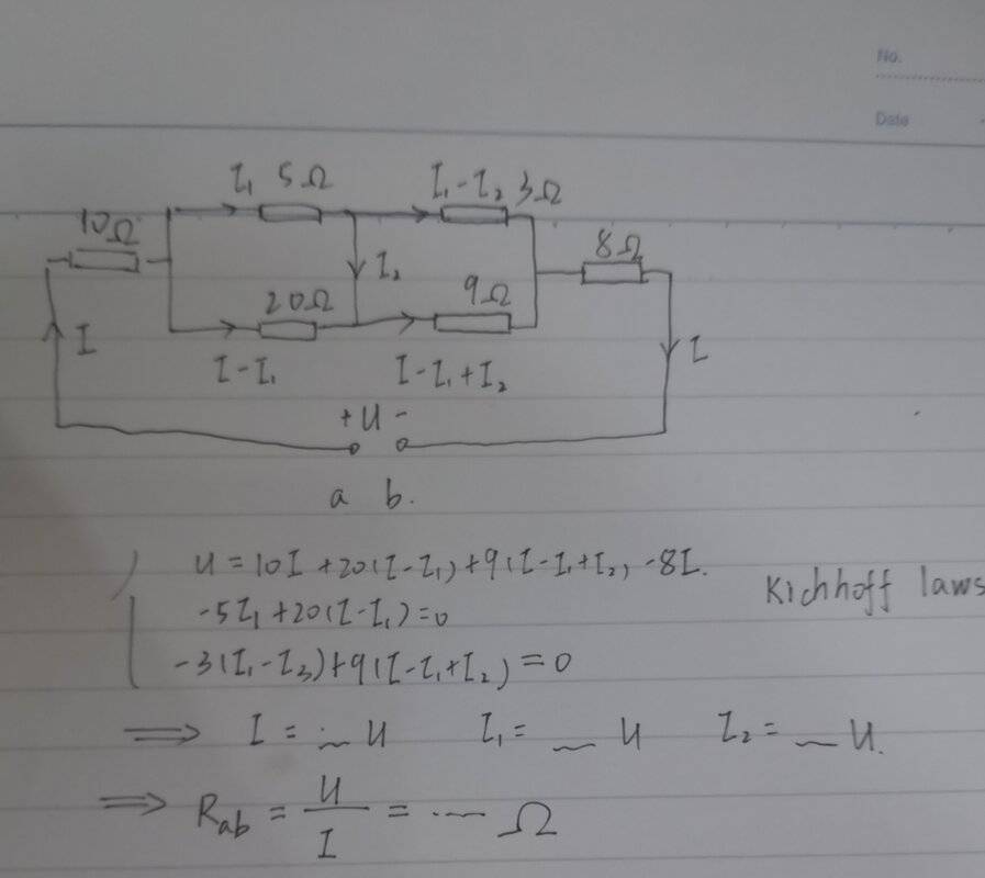

Maybe you can solve it like this (In China we called it Current distribution method )

Yes, I think you can. The most difficult problem here is that the schematic is drawn in a confusing way. Redraw it so it makes more sense to you.
@gneill has given you a way forward, pursue that. For example what is the resistance between node e and node cf?
