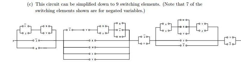

In summary, the problem is given in the picture attached and it is a network of switches. The Attempt at a Solution is to simplify the expression to 9 literals, but has been unsuccessful.
toforfiltum
341
The problem is given in the picture attached. It is a network of switches.
I managed to simplify the expression to this:
## (S + x'(w+y) + xvz)(x'+y)(v+z') ##
but I just can't find a way to simplify it to 9 literals. I've tried all different methods I can think of, but I just can't find the trick.
The last method I came up with(that I thought was pretty close) was this:
##S(x'+y)(v+z')+(xvzy+x'y(v+z')+xvzy)##
I tried to multiply out the expressions to the right of ##S##, hoping that I could eliminate the duplicate literals. I thought that by adding the extra literal ##xvzy## I could eliminate more literals, but this approach didn't work. I'm really stuck. I have been trying this for hours. Any ideas?
Thanks!

toforfiltum said:
##(S+x′(w+y)+xvz)(x′+y)(v+z)##
Can you explain how to count the literals in this expression?
I would count the number of terms in a SOP form. Would that be right? So I think I may be wrong, 9 circuit elements means just 9 switches?
Where does the goal of fewer than 9 come from? Are you given the answer?
I count 7 literals in your expression I quoted.
I'm sorry, although I now understand the distinction, I still can't get the right answer
I'm not too sure if I know what the question asks, but it states that the final form needs to be simplified to 9 switching elements. And no, I don't have the answer.
Does a switching element correspond to a single switch? If so, I must simplify it to 9 switches.
Nine switches sounds a reasonable goal. Before you spend many hours trying to simplify to 9, it might be worth demonstrating that ##(S+x′(w+y)+xvz)(x′+y)(v+z)## does still correctly correspond to your original figure, perhaps test both for a couple of sets of arbitrary inputs. It would be easy to have an error creep in.
