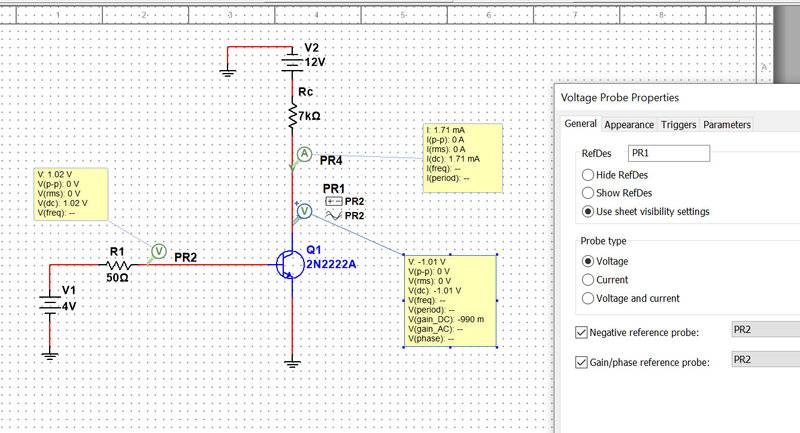

I am using Multisim software and I am comparing my calculated voltage gain with the one, done by Multisim.
Why is calculated Av ( -478.8 mV) much different from the one in simulation ( -990 mV) ?
I see the calculated is approx. half size of simulated.
I tried using virtual transistor instead of 2N2222A, but Ic and voltage gain inside Multisim stays almost the same.
And tried also moving PR2 voltage probe directly on 4 V power source.Ic is seen as measured on schematic
Rc is seen on schematic
Vt is default 25 mV at room temparature
gm represents transconductancegm = Ic / Vt = Ic / 25 mV
gm = 1.71 mA / 25 mV
gm = (0.0684 / 1000) S (Siemens)
gm = 0.0000684 S (Siemens)
Av = Rc * -gm
Av = 7000 ohm * -0.0000684 S
Av = -0.4788 V (volts)
Av = -478.8 mV
The gain of that your circuit will be highly dependent on the current gain assumed for the 2N2222A. What value of beta is being used ?

I would suggest substituting a simple T-model for the transistor with parameters you can directly set. Do the analysis on paper and compare with the simulator's answers. If that all makes sense then move up in model complexity. This will separate the nature of the problem you have, i.e. simulator problems, your basic understanding of the circuit, BJT model issues, etc.
A few things caught my attention:
1) Multisim shows the Collector voltage as -1.01V, pretty good trick with only Positive supplies
2) I calculate the Base current somewhere between 60mA and 66mA
What would you expect the Collector current to be with 60mA base current? Is that current possible with the Vcc supply and the load resistor?
How does the calculated Collector current compare to the maximum rating of the transistor?
Me thinks that circuit got Multisim very confused! :eek:

Base bias current is ( 4V - 0.7V ) / 50R = 3.3 / 50 = 66. mA ;
Multiply by beta (assumed 100), gives Ic = 6.6 amp ;
That transistor, ( with Rc = 7k ), is saturated.
I think you have your resistor values swapped.
R1 is 50R, maybe it should be 7k.
Rc is 7K, maybe it should be 50R .
Then Ib = 3.3V / 7k = 470. uA ;
470 uA * (Beta=100) = 47 mA ;
Rc = 50R ; Vrc = 2.36V, which is less than 12V, so BJT is in the linear range.
Now the BJT is biased, you can evaluate the AC gain.
I believe this is part of a lesson, in how NOT to design an amplifier.

This is about as predictable of a circuit as you can get with a 2N2222. Even the most horrible beta will put the collector voltage next thing to zero. However, it won't go negative. So much for my faith in that software. It is an amplifier, just not a linear one. I don't think there ever was a claim that it was.

Not if your reference is the base voltage, which is what that Microsim widow is telling you. BJT collectors in saturation can absolutely be below the base voltage when driven hard into saturation.

For this circuit? Saturated. It has little to do with the amount of base current, you know, once you have way too much.

This isn't Multisim's first rodeo. Your best first guess is that the simulator is doing exactly what you asked it to do.
BJT amplifiers normally have separate functional bits in the schematic for DC bias and the AC signal. You have biased this device into saturation and it's no longer an amplifier.
